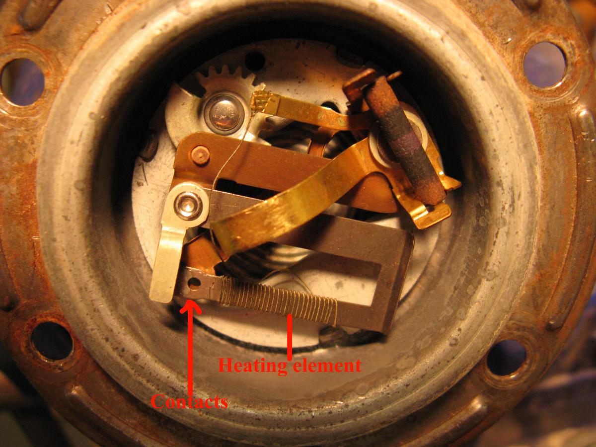

TomO | -- 01-01-2020 @ 8:26 AM |
I would check to make sure that there is 6 volts at the wire on the sending unit, with the engine running at idle in your driveway. If you have 5.5V or less, check your battery and connections at the gauges. If the voltage at the sending unit is good, take a jumper wire and connect one end to a screw holding the sending unit in place and the other end to the body floor. If you have a bad ground, the gauge will now read the tank level. In your other post, you said "I cleaned the inside real good with contact cleaner, put everything back together and still the gauge would only show 1/4 or less. " Did you mean that you cleaned the inside of the sending unit by prying off the cover and spraying contact cleaner inside area shown in the photo? You can do an electrical test of the sending unit by disconnecting the wire from the sending unit, remove the unit from the tank and connect an ohm meter, on the X1 scale, between the terminal and the case. Move the arm slowly through the range of movement while watching the ohm meter. The needle on the meter may fluctuate as the arm is moved but should indicate 0 ohms through the movement. If you get a high reading, you will have to clean the contacts inside the unit. Be careful of the hair like wires inside the unit, they break easily. Tom This message was edited by TomO on 1-1-20 @ 8:35 AM
