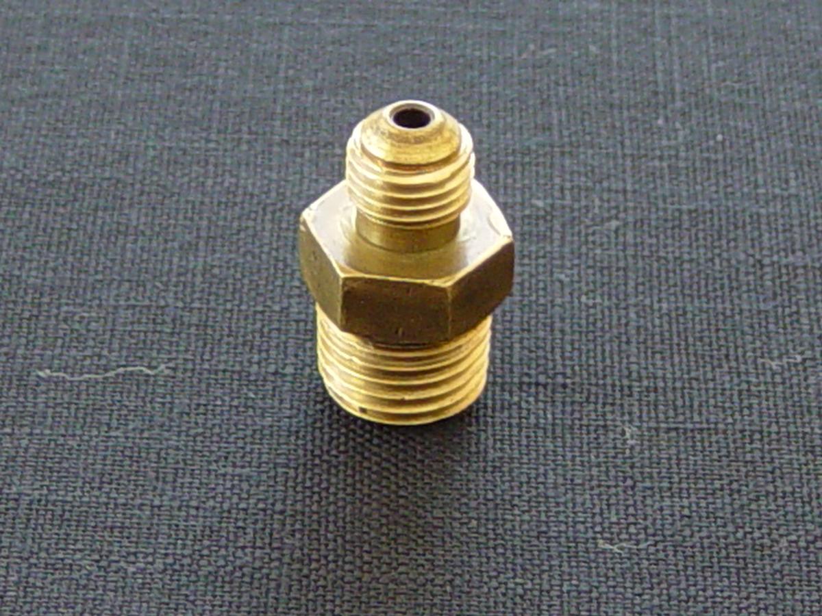

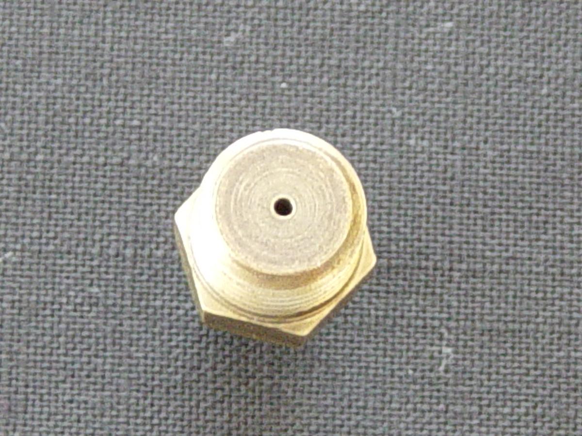

40 Coupe | -- 01-02-2020 @ 4:28 AM |
The AC oil filter, restrictor fitting, below and also pictured in the 37 restoration book, it screws into the engine block. You can have original style flex oil lines made. Or are you trying to repair a Fram filter???? This message was edited by 40 Coupe on 1-2-20 @ 4:43 AM
