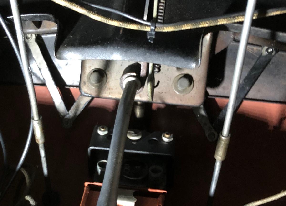

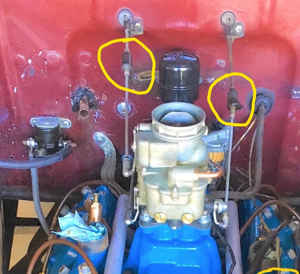

For a '37 , how are the throttle and choke rods connected to the rods? Are they threaded into a connecting collar/coupler or just a crimp.

Mine appear to be crimped.

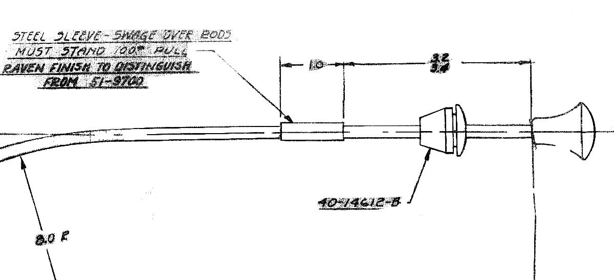

Here is an engineering drawing of 35-36 rods showing swaged sleeve. 37 was the same.

Thanks. Both comments have determined my next step to cut the collar in the center.

Good questions on how fix the swaged sleeve. In Don's post, the note says that the swage must stand a 100 # pull. My first thought was to use a crimping tool typically used on spark plug wires. I had imagined an aluminum sleeve. More thought and trials are required to see if that is practical. Another approach is to thread the parts. I am sure that someone will jump in with better solutions.
