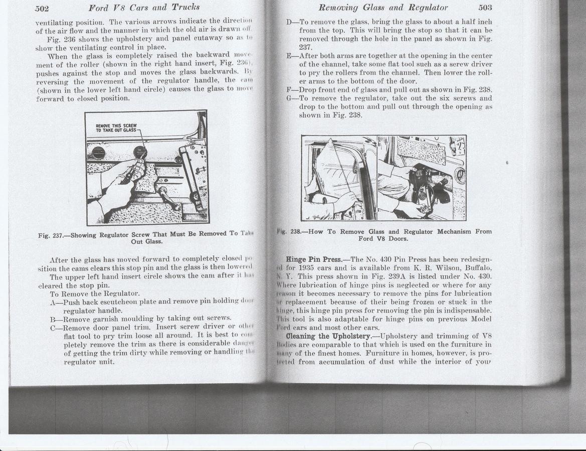

I have obtained new glass for these windows and have blasted and re-painted the channels they get set into, but what is the best method for getting them back into their positions. Do they go in from the top or from below? I'm assuming the regulators go in after the glass is in the body walls. The main reason I'm wondering is because it appears that in my car, the interior panelswere bent outward in a rushed effort to strip the car, and I don't want to do any damage getting the glass back in. Thanks. Leon
4dFordSC | -- 10-10-2019 @ 1:06 PM |
This might help.
Topic: | https://www.earlyfordv8.org/forum/viewmessages.cfm?Forum=18&Topic=13298 |
