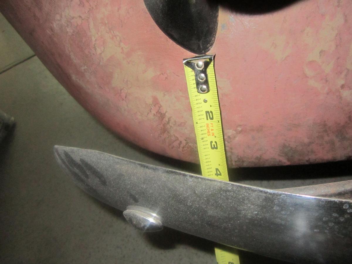

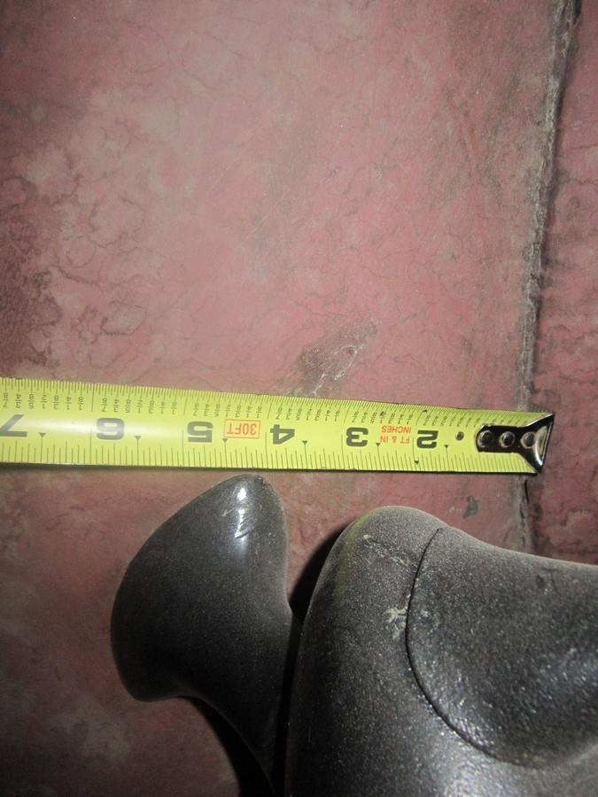

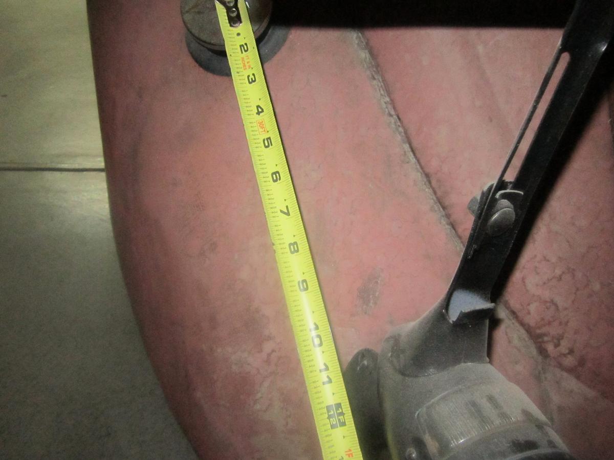

Okay. I have the 37 tail light stands. I also have the 37 Ford Book. It doesn't show how far up from the bottom the tail light stands go. See. When I bought my !937 Tudor. The owner before me put 1939 tail lights on it. I welded everything up today. I have been looking at the Ford book, but can't judge where the stands would sit. I have a slantback. I keep checking to see just where to put the so the license plate won"t be in the way of the deck lid. Is there a site or someplace where I could see a measurement from the bottom of the fender to the bottom of the stand, and from the channel of the trunk to the side of the stands..Thank You.

Hello, These pics are of the tail lamp mount base on a 37 Tudor Slantback. The third pic measurement starts at the center of the gas cap for reference. I can take more pics/measurements if you want. gregg

Thanks. That helped a lot..
