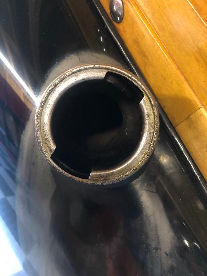

I have a 37 Ford Deluxe woodie wagon, which is (was) immaculate since I purchased in 2014. Since I've had it, fuel has been leaking out of the gas cap and/or the breather hole in the filler neck (just above the fender/gasket) onto the fender. I have replaced the gas cap several times, along with other remedies such as placing various splash reduction objects in the filler neck. These efforts have reduced the flow but not stopped it. At this point the paint on the fender is heavily stained and most likely ruined. The paint was perfect when I bought it, and the previous owner swears that he never experienced the spill/leak. Hard to believe that it 'just happened', however... nothing has really changed. I ordered a new filler neck and cap and leak-tested it just in the sink before installing, and THAT leaked out the cap (not out the breather pipe)... so I did not install it. But now I'm stumped. I would really appreciate any suggestions or insight! I would be especially grateful for any close up photos of your gas cap & filler at the fender just to make sure mine is properly positioned. Thanks! Bill kuipers@earthlink.net 973-600-5557

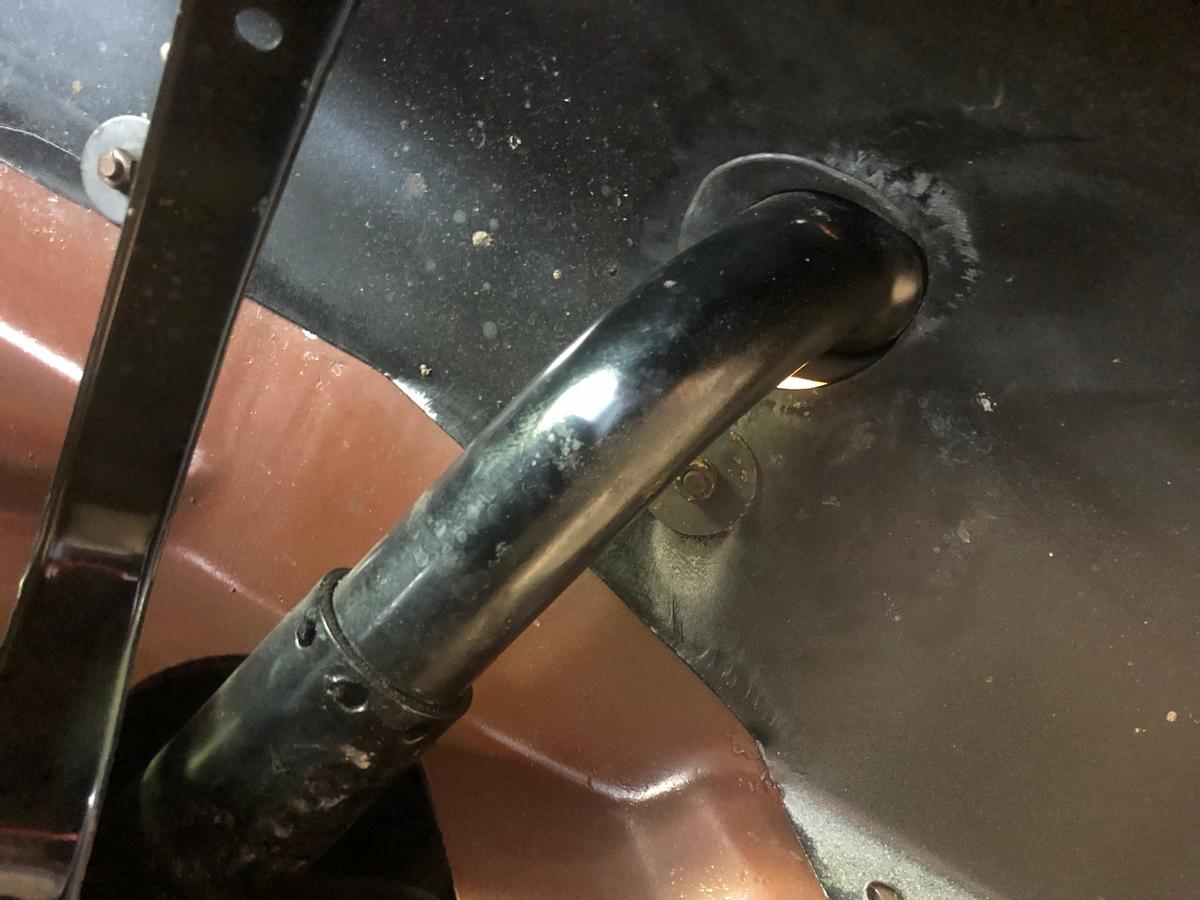

The filler pipe is not far enough into the fender and your leak may be coming from the vent pipe at the top of the filler pipe. It should be venting the tank on the inside of the fender. The 37 Station Wagon uses that same tank as the 36 cars (P/N 68-9002). The filler pipe for the station wagon is the same one used on the 36 Station Wagon (P/N 68-9034-B), it may be different from the passenger car pipe. If you belong to the Woodie Club, look in the roster for an owner of a wagon like yours and contact him. Tom

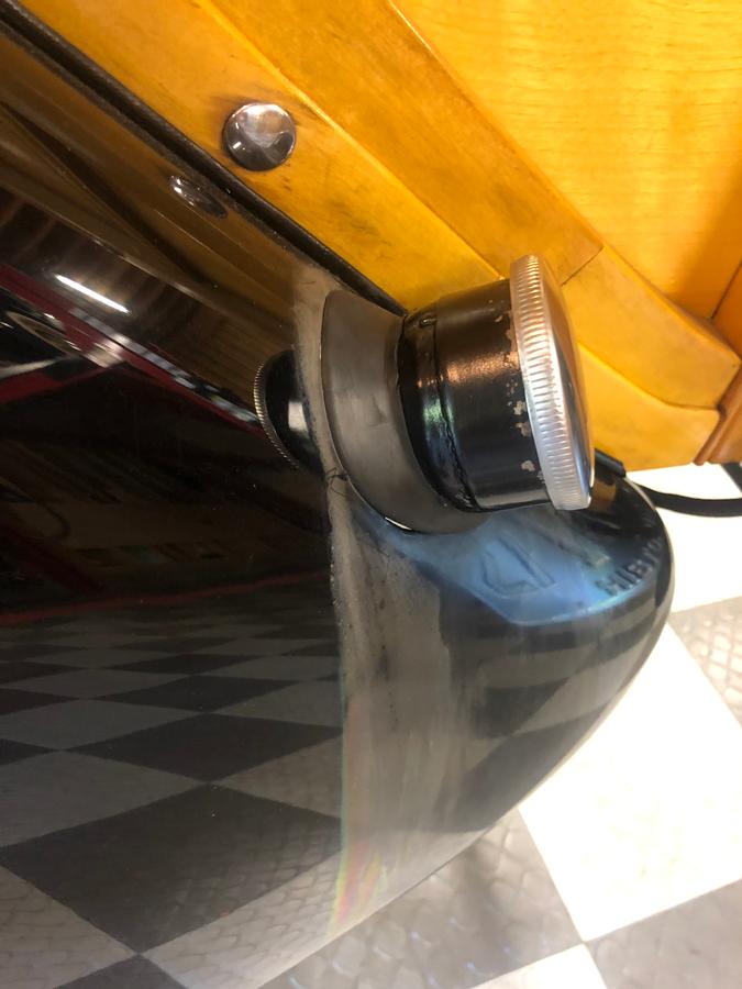

hi leaking filler neck 37 wagon, by the photos I see, the filler pipe is pointing to the back of car and not up, try turning it to the front of car, just a little , the grommet could be installed maybe now,, this might be the problem ? and the rubber grommet should fit all around the filler neck and fender did you ever lay a straight edge over the filler neck to see it is flat, if should be smooth, so the gas cap gasket seals, all old piece of flat metal, anything flat hope this helps 37 RAGTOPMAN try turning the filler pipe and see if that is the problem

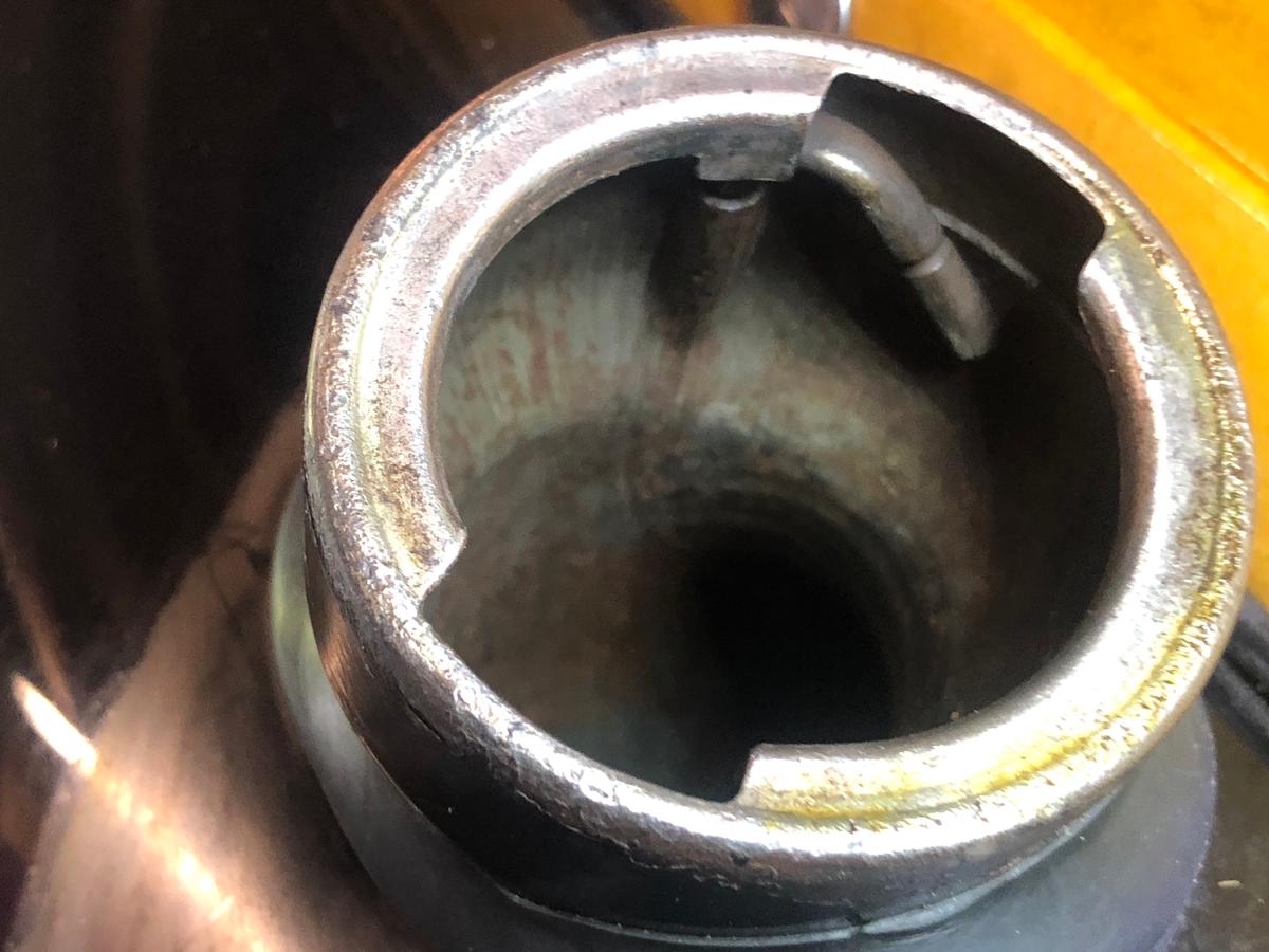

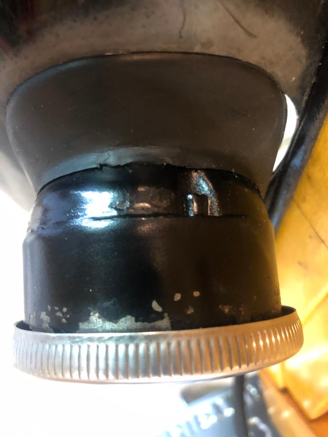

The filer neck is standing too tall out of the fender. The tank is not breathing. The neck of the tank should be about 1" above the grommet in the fender. The neck is not down far enough in the rubber connecter to the tank. As I look at your photo you can see where the vent tube exits on the outside of the neck. It's possible the vent tube is plugged up. Use a small wire to check to see if the vent tube is open. This message was edited by trjford8 on 6-29-19 @ 9:42 AM

It is possible there are a couple of problems: Your gas cap should be of the non-ventilated type. If there is a small vent hole inside the cap near the rivet yours is vented, fuel will come out the vent. Your fuel system does not need the vented cap since the small J-shaped tube handles the venting. There seem to be problems with all the reproduction filler necks supplied by all the parts suppliers. They are not a correct fit. You may want to look for an original Ford neck if you can not realign the neck properly as described above.
