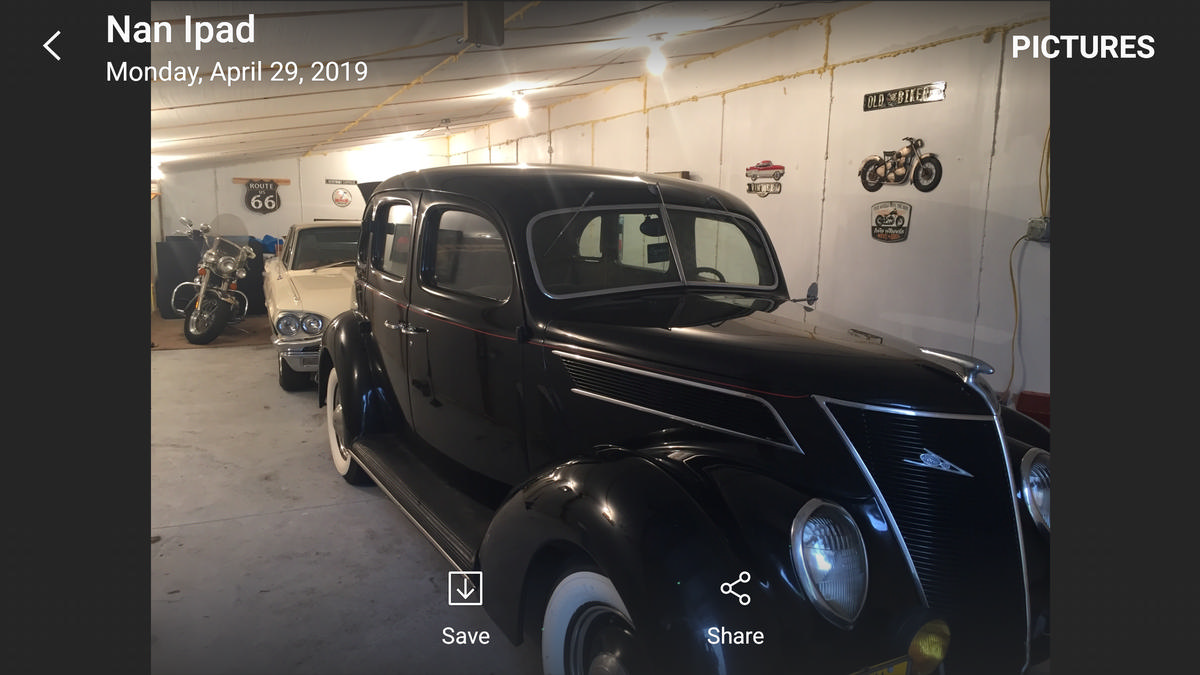

Hi, it is a pleasure to be apart of this club. I have a question, I just bought a 1937 ford four door sedan at the rod run in pigeon forge Tennessee last week. the headlights worked when I bought it. I brought it home to Michigan on a uhaul trailer and when I got home the lights don't work. I hope I can get some help on where to start looking. maybe something jarred loose on the 600 mile trailer ride home. any help will be appreciated. Thank you in advance. This message was edited by JakeArtie1994 on 4-30-19 @ 7:14 PM

Jake Nice car, and the one behind it too. After I bought my '46 Super Deluxe Coupe last year, I went and collected as many related manuals and parts books that I thought would help in restoring, repairing and maintaining my car. The most helpful tool I had when it came to sorting out the electrical, gauges not working and dim lights, was my multimeter. It can check volts, ohms, amps and a few other things. I quickly learned, that the old Mk-1 eyeball, can't tell how good a ground or electrical connection is, or whether a fuse has failed. Have fun and enjoy you new ride.

51woodie, thank you very much. Yes that was a real lesson for me. I looked at the fuse and thought it was good. And then when mg told me to check the fuse, I just took it out and put a new one in, and bingo all my lights work. I fell in love with this 37 when I saw it. I also have a 1918 Model T, but those are so simple it's amazing, and I have that's 64 Thunderbird you see in the background, and I'm also looking for a nice Model A.

Your 37 is a very nice looking car, it looks like it was well cared for. You should do a visual check for frayed wires in the headlight circuit. There has to be a reason for the fuse to blow. Tom

Thank you Tom I did look everything over pretty well and laid under the car looked at all the wiring and it all looked good. When I loaded the car in Tennessee the lights worked and I didn't have them on for 600 mile trailer ride home and when I started it up to drive it off the trailer it was night here at home and I had no lights so I'm thinking the jarring of the trip may have ruined that fuse, because it was just a little thin line fuse. But I don't think it's a frayed wire or anything because they worked when I loaded the car 600-mile ride later I started the car and they didn't work so I don't think the fuse blew while the lights were on. Thank you for the compliment on the car, it's only got fifteen thousand seven hundred miles on it and old couple in Virginia owned it, and it is clean underneath is it is up above it is a very nice car oh, that's what made me fall in love with it. The radio doesn't work and the clock doesn't work but I will address that later. Before I bought it I had a guy looking over that knows a lot about old cars because I didn't think that mileage could be true, and he said yes he believes it to be true and the car has all the earmarks of sitting in a garage all its life oh, it's got a paint chip hear a paint chip there from things being dropped on it or hit against it. He said he would believe that the odometer is correct. The odometer does work and the speedometer works gas gauge works at meter works everything in the car works very well. And it literally drives like a dream.
