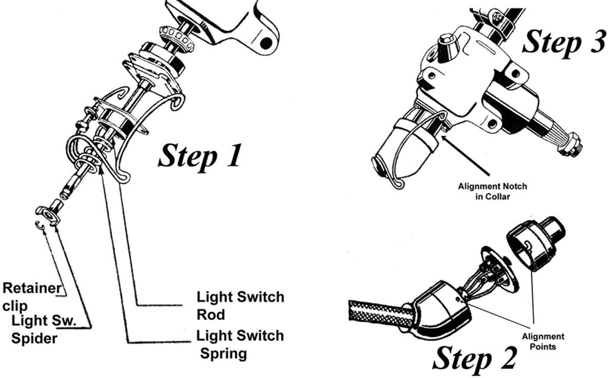

If I understand your question, it sounds like the light rod/horn rod is not staying tight against the steering wheel? If that is the case, it could be that the clip at the end of the rod, in the light switch bail, has come off. If so, you will need to get under the vehicle and un-clip the wire bail that holds the switch housing on the end of the steering sector and see if the little "U" shaped clip is there. The clip slides into the rod and holds the switch on the end of the rod. If not, then we will need a little more information. Or a photo of the part in question.

Review the attached images to see if you have all these components at the end of your steering column.
