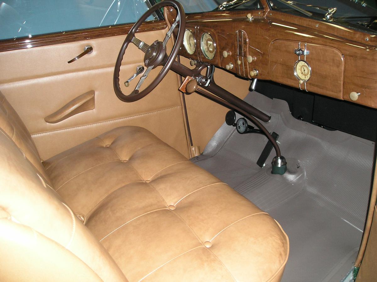

Hi, I’m restoring a 1937 Convertible Sedan here in Brazil and I’m not sure about the color combinations - dash and windows trims.The car is in a full restoration and the body color is Vineyard Green. Need help on this. Thank you.
3w2 | -- 04-07-2019 @ 9:16 PM |
The dash and window moldings were originally wood grained like in the photo below.
