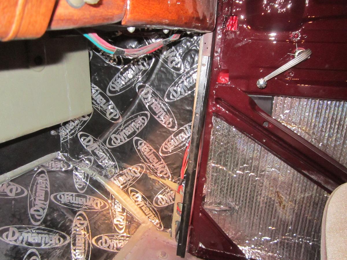

  Hello,
I am restoring my 37 Sedan Delivery. The interior kick panel (aka cowl panel?) is held in place, in part with a vertical trim piece that screws into the door jamb area/post. What is the panel made of and what screws or nails are used to hold the metal trim piece in place? One other question...what is the original color of the trim piece?
Thanks for your help.
gregg
kubes40    -- 04-02-2019 @ 4:51 PM
  The panel is cardboard.
Slotted - flat head screws. I think #8's. Not 100% certain.

1937sedandelivery    -- 04-02-2019 @ 5:52 PM
  Thanks Mike.
Call me anal...call me whatever you want...I try hard to make everything as original as possible. I do take liberties sometimes, but in general, I want it to be like Henry built it.
That said, one of my 37's is a mish mash when it comes to the undercarriage, but the other 37's are going to be as original as I can make them.
Case in point, awhile back I set out to find out what "color" Rustic Brown really is. After a lot of investigation, I came up with a ppg color that looks identical. I tested it on a 37 mirror stand which was in good condition. I masked off half of it and painted the other half with the ppg paint. It was hard to tell them apart.
Anyway, thanks for the information.
gregg
1937sedandelivery    -- 04-02-2019 @ 6:49 PM
  Okay, call me lazy also.
I pulled out a couple of my reference books and found the following:
From the Body Part List book for 1937, page 58, the cowl panels are listed:
78-700685-C: cardboard cowl assy, brown fine colonial grain, R.H.
78-700684-C: cardboard cowl assy, brown fine colonial grain, L.H.
78-900696: Retainer (cowl) cardboard, R.H.
78-900697: Retainer (c0wl) cardboard, L.H.
32916-S2: Screw
From the Automotive Hardware and Trimming Supplies book, 1928-1938, page 156:
32916-S2: No.8 x 3/8"
You were right on.

kubes40    -- 04-03-2019 @ 5:50 AM
  Good morning Gregg,
I'd asked about your concern as I noted the plastic wiring... I didn't figure were restoring this vehicle but rather, simply putting it together nicely.
The cardboard with that grain was available from LB. Unfortunately for all of us, that is no longer an option. I am unaware of any alternate source. Hopefully, someone else knows and can help you...
1937sedandelivery    -- 04-03-2019 @ 8:15 AM
  Yeah, good catch on the wiring. Obviously it's not the original cloth stuff. And I put dynamat everywhere I could. Even with that, the Sedan Delivery sounds like a big echo chamber when I drive down the road. Upholstery should help some. The rear quarter paneling is made of Masonite, which probably isn't the best sound absorbing material around.
