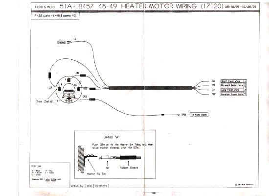

I have a '48 Business Coupe that I'm building. It came with a heater that turns clockwise for defrost and CC for heat. The heater is stamped Eaton on the mounting. I have found a reversible motor that will fit (original one was missing). I am in search of the fan control switch and wiring diagram to wire the switch. Can anyone out there help? Thanks
Drbrown | -- 03-06-2019 @ 9:05 PM |
Here's the wiring diagram for '46 -'49. To find a switch, you'll need to look thru the Classified here, the Swap Meet at the Ford Barn, the HAMB forum sales, and Ebay in their Ford Flathead section. I recommend a used or NOS switch rather than a repro (if there are any around). Do not run power to it from your ignition switch. Use a fused power source from battery. PS: My late '47 has tan knob with red lettering/markings. I believe a '46 would have black lettering. This message was edited by Drbrown on 3-8-19 @ 8:42 AM

Their pricey because their hard to find and are usually missing the chrome bezel that goes ofer the outer nut. Also they must have 4 connections on back side NOT 2 as on most of them you find. ken ct
