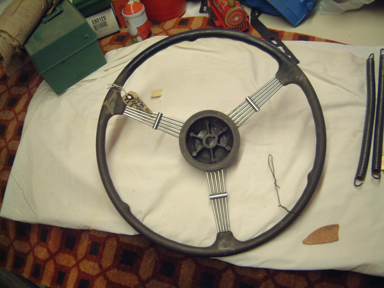

As it has already been established, Ford's earlier than '36 did not have banjo steering wheels. Since the banjo type of steering wheel is not original equipment to your '34, and you are dead set on having one I would suggest you use a '36, as stated, they are a flat type wheel in lieu or being curved, therefore the '36 might look more stock. A word of caution, the original banjo type of wheel have many problems, it is very common for the 'spokes' to be quite loose from many years of pounding across bad roads, and the hard rubber can be very badly cracked. I have attached a pix of a '36 wheel that I have had for almost forty years. The spokes are in great shape, no looseness, the hard rubber part needs repair, which have been started using 'Bondo'. I had intended to convert my '36 back to a floor shift in lieu of the column, gathered all the parts needed, then changed my mind... Bill 36 5 win delx cpe
