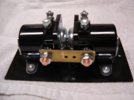

I always install a battery cable with two "eye" ends from the ground strap connection at the firewall, and one of the starter mounting bolts. This helps the starter, and connects the rest of the vehicle to a solid ground. As to the lights and connections, I agree that the "bullet" connectors are often a problem. We make sure the ends of the connection are clean and bright, a slightly crimp the sleeve to assure contact. Repro connectors are usually poor quality, and putting a piece of heat shrink over the connection will prevent it from working loose. On my '47 the headlights were dim. Most of the power was lost in the maze between the battery, light switch, dimmer switch, and the bulb socket. I made a relay board using two starter solenoids and operate then from a position on the left side inner fender by inserting the connections between the original circuits and the headlight. It now has lights bright, or better than new, and operates with the original switches.
