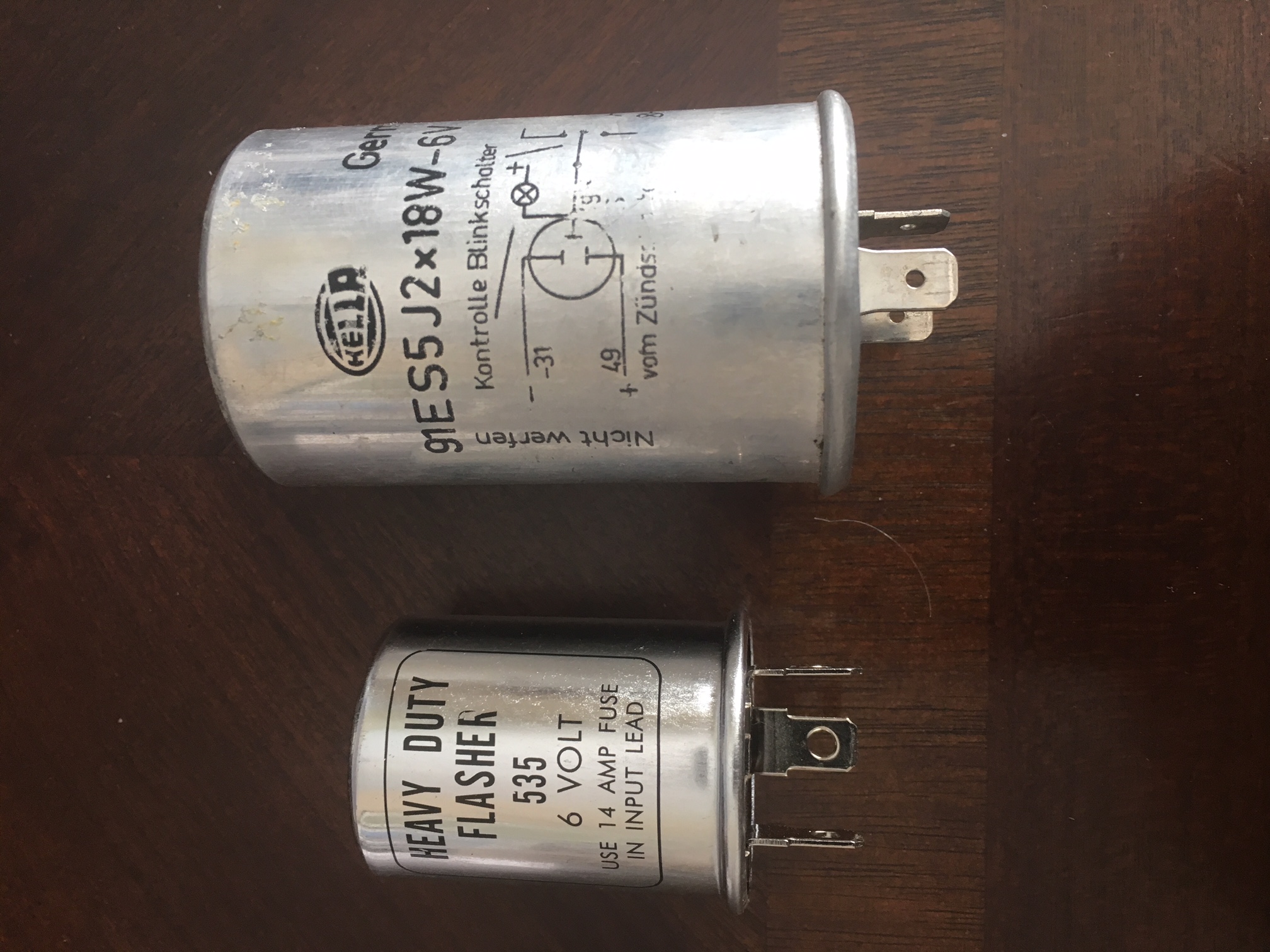

51woodie | -- 10-02-2018 @ 9:53 AM |
A previous owner installed a United Pacific turn signal kit on my '46 Coupe. The signals worked okay but the indicator lights on the switch did not. The flash frequency was quite fast as well, so I thought a new flasher unit would solve the fast flashing. The existing flasher was a Hella unit, but I purchased and installed a 6V #535 HD flasher in its place. Voila! The lights flash at a reasonable speed, and now the indicator lights on the switch work for both signals and emergency. And here I was thinking I would have to pull the switch appart to sort out the non functioning indicators. Sometimes the hardest problem is so easily solved.

51woodie | -- 10-03-2018 @ 6:15 AM |
mfirth. I bought it from Summit Racing, as I was buying fuel and oil filters and 6V headlamp at the time, but you can also get them from NAPA as P/N, NF 535 at a better price. The flasher is not loud enough for me to hear (old ears syndrome), but the bonus was that the indicator lights now flash to remind me to cancel the signal.
