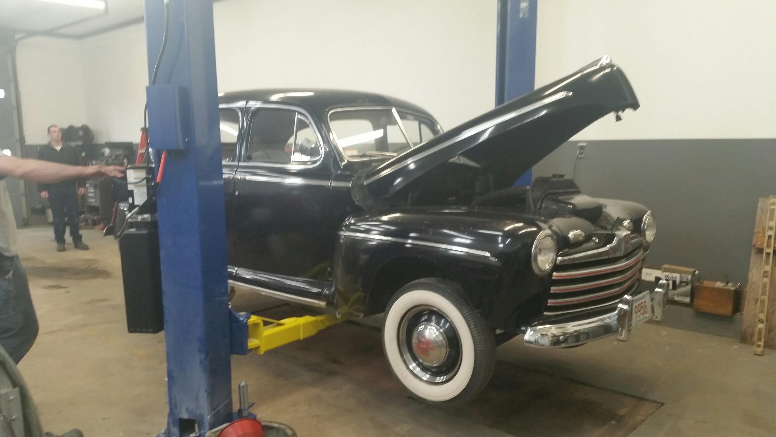

My stock 46 coupe starts on a 1\4 turn, idles and accelerates smoothly, and runs very nice at all speeds. Gas gauge is not at all accurate so I watch the mileage. It was reading full yesterday when I put in 12 gallons after driving just 86 miles,. or just a little over seven miles per gallon. Whenever I fill the tank,I have a strong odor of gasoline in the garage for about 3 or 4 days afterward. Checking the engine bay, there is no sign of gasoline on or around the carburetor or anywhere else atop the engine. . Electric fuel pump is set at 2 1/2 lbs and mounted along the rail just ahead of the tank, No evidence of gasoline on the floor there or anywhere else. Both exhaust tips show smoky residue indicating it is running rich. I have a steady minor oil leak,apparently from the front seal. About the size of your palm over a week or so. However, in checking the oil stick it does not reflect any loss of oil - SO - I assumed perhaps the gas is leaking inside the car and down into the intake manifold. Pulled the dipstick and no odor of gasoline. Oil appears very normal, and lighting a match to it produced no flame Engine requires just a little choke for a short while on a cool morning - which seems very normal to me and not like a an engine overloaded with gasoline. I am stumped would appreciate any suggestions . .
