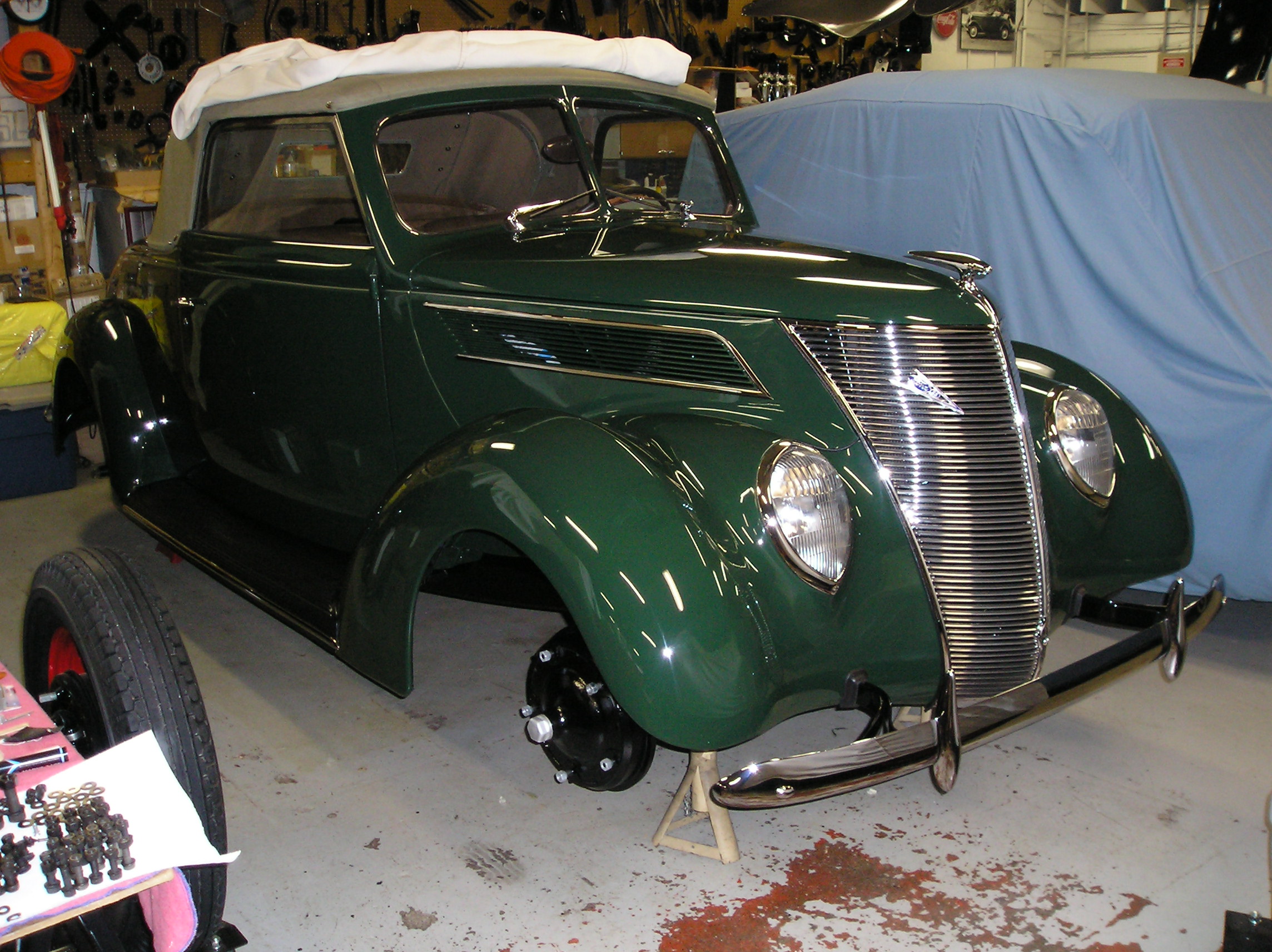

3w2 | -- 09-26-2018 @ 4:47 PM |
The attached may be helpful, at least for the front half of the stripe as it is the same for all U.S.-built '37 passenger cars.

ravi.avalur | -- 09-26-2018 @ 10:05 PM |
Thanks you ! Very similar to mine, two doors less, a cabriolet I assume? I am taking a print out of this and comparing it to the stripe that that I currently have on the car (this picture was taken last year). I must repaint certain panels so thought it best to correct the stripe now if needs be. Mine seems to be slightly different , your opinion much appreciated.

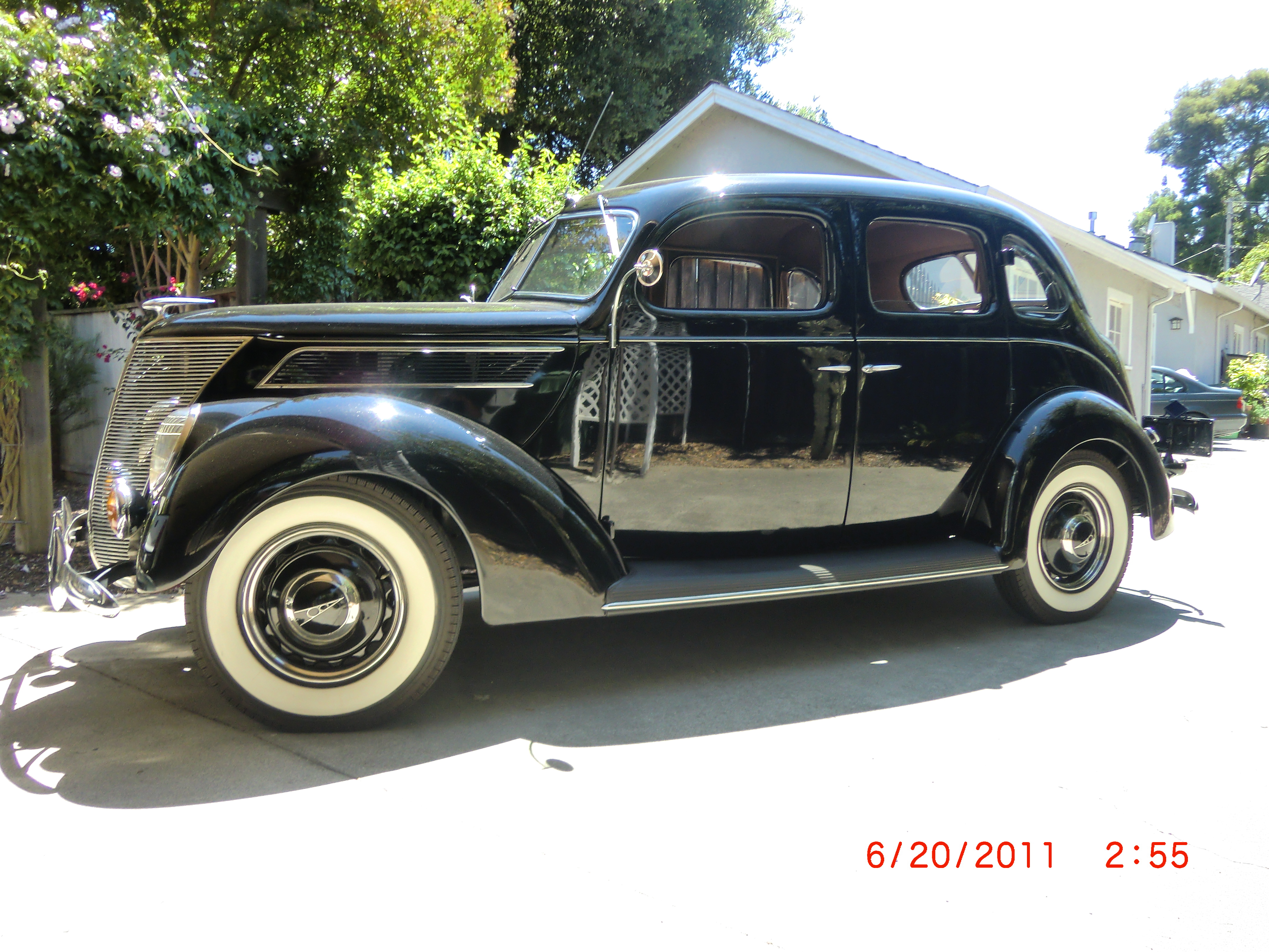

MG | -- 09-26-2018 @ 11:06 PM |
Here's a picture of a Fordor Touring Sedan that may be helpful....

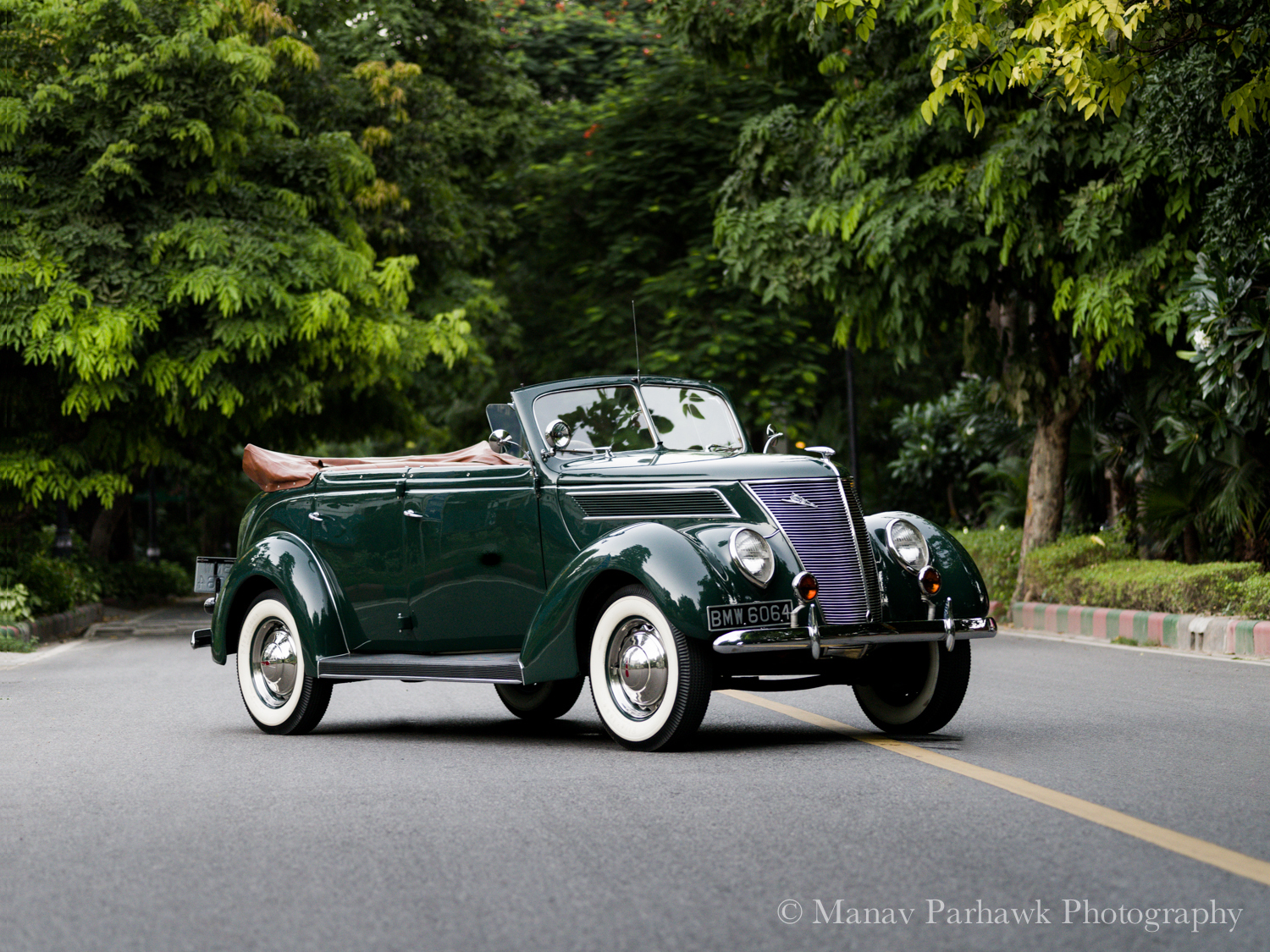

ravi.avalur | -- 09-27-2018 @ 10:48 PM |
The paint shop is part of a specialist car restoration workshop (the best we have here in New Delhi). Be that as it may, I am concerned because he hasn't much experience with Ford V8s. Would be very grateful if you could have a look at the stripe on the car in the picture and let me know whether it is correct or , if not, what could be improved. I will have to guide them as they are best facility I have locally. If that picture isn't clear enough, I have many more. I am very grateful to you for sharing your expertise. If you ever come out to India, I'd be happy to take you for a drive.
