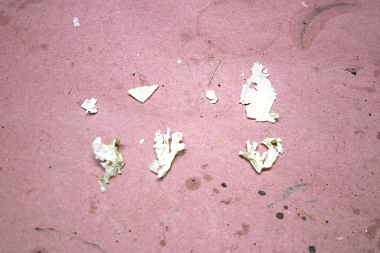

Recently while driving my 1937 Ford 78, the engine died. It felt like I ran out of gas and coasted to a stop. After getting a tow home, I found some white stuff in my sediment bowl. I also found a wad of this same stuff at the union of the steel line to the rubber line leading to the fuel pump. See picture. To me it looks like pieces of a plastic shopping bag. It is thin and somehow apparently gets sucked up through the fuel line. So, there must be something in my gas tank. Anyone ever see anything like this? Thanks Mike

My guess would be that someone used teflon tape to seal a fitting and that is what you are looking at. If that is the case you are lucky and there won't be anything in the tank. Charlie Stephens
mzahorik | -- 09-24-2018 @ 11:28 AM |
Could be, but these pieces are larger than 1/2" tape. The unfolded piece is about 1 inch square. Mike
woodiewagon46 | -- 09-24-2018 @ 11:49 AM |
If someone used the old type gas tank sealer, it may be being attacked by the new ethanol fuel. From what I have been told the two aren't compatible. Those pieces look much bigger than teflon tape.
6lucky13 | -- 09-24-2018 @ 1:35 PM |
That was my thought also...gas tank sealer peeling off the tank surface. Kerry Kerry
mzahorik | -- 09-24-2018 @ 1:46 PM |
Geezzz.... if it's old sealer, I'll have to remove the tank and get it cleaned. Maybe once the tank is out of the car I can get a better look inside. Mike
