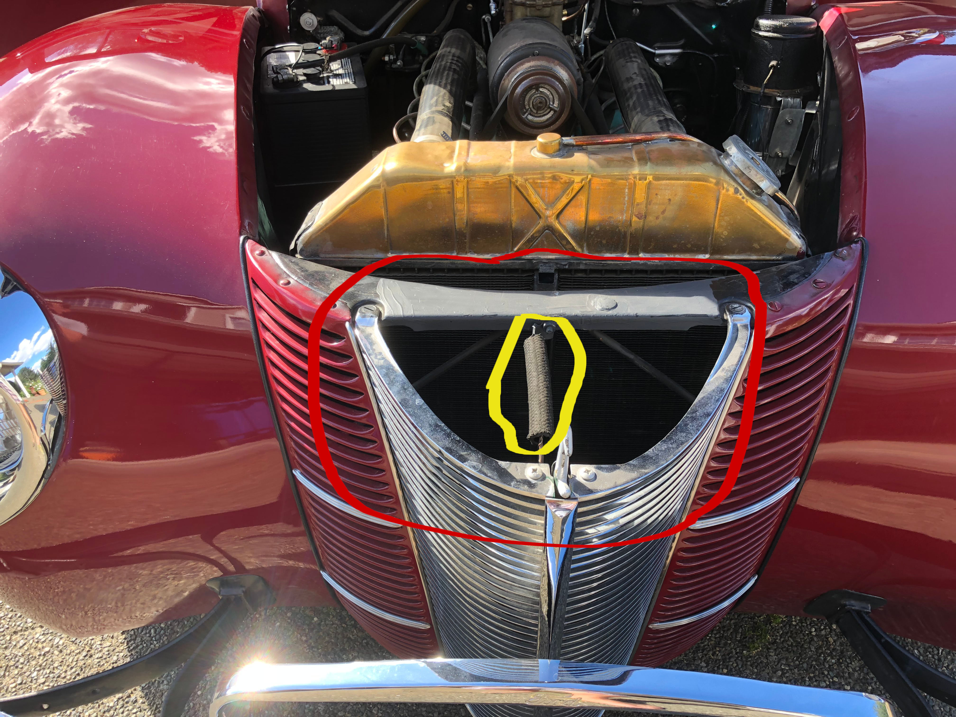

Hi, I think I'm missing a part from my grill in red. I think it some kind of deflector. Also, that cross bar that holds the grill (in yellow). What are the names for those parts? I cannot figure it out from the Mac's catalog without a picture Thanks, Eddy

Good Morning, Eddy--- The "deflector" you mention is called a Grille Center Plate - part # 01A-8209. The "cross bar" is called an Upper Grille Brace - Part # 01A-8145-B. Bob Drake's 1940 Ford Parts Catalog - pg. 27 - has them listed at $60.00 and $125.00, respectively. It's available at www.bobdrake.com. Lots of helpful, easy-to-understand photos in the catalog too. Nothing against Macs! I have ordered parts from them in the past. Good firm - good service. Good luck. Tom

Thank you! Eddy
