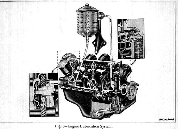

Tom() I am ignorant of how the intake galley receives oil? So the galley sludge does not impede lifter/valve stem lubrication?
TomO | -- 09-09-2018 @ 10:20 AM |
Here is a diagram of the oil flow system in the 49-53 block. The 32-48 is very similar. The valves and lifters receive their oil from splash from the camshaft and the valley is just used a a return sump. Tom
