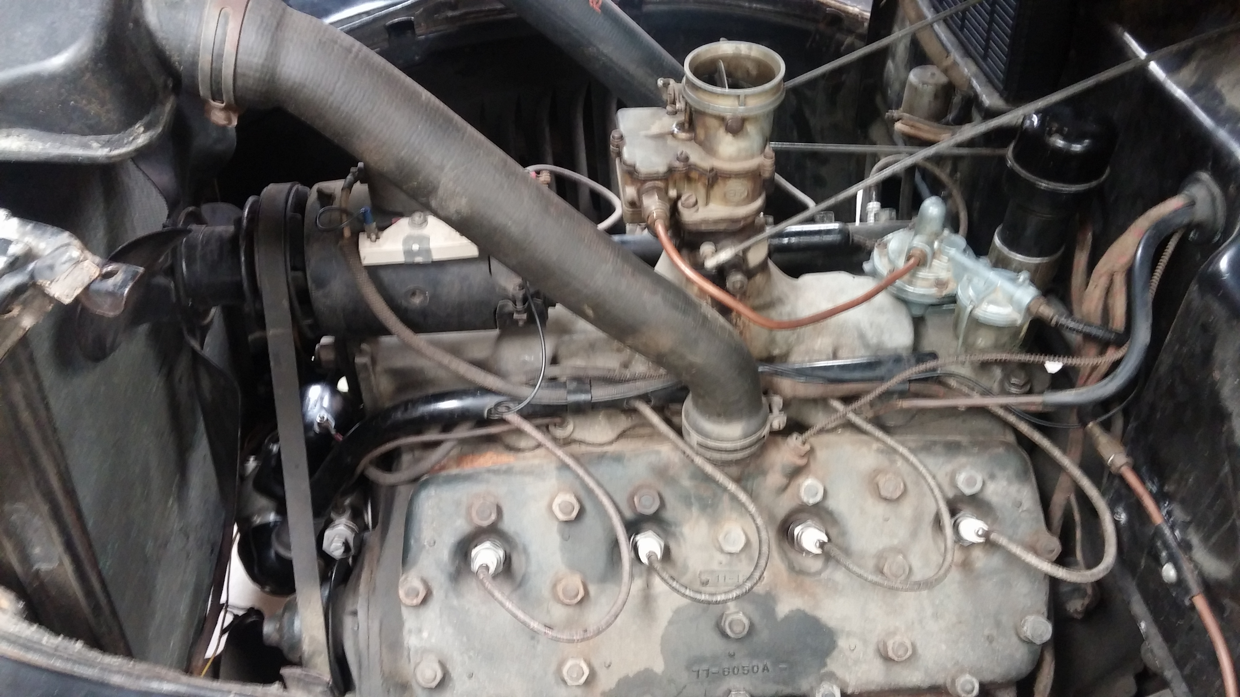

I recently purchased a 37 model 78 slantback. Located on the dash is a pull rod for the choke and one for the throttle. The throttle rod does not seem to have any effect on the car when it's running. I'm still working out some issues with the engine but this has me confused. Thanks for listening. John

Raise the hood and have someone work the throttle back and forth and see what is happening. If its working, check and see if the throttle lever is opening the butterflys.
TomO | -- 09-01-2018 @ 7:28 AM |
Try pressing on the gas pedal while pulling out the throttle. When you let off the pedal the engine speed should stay the same. Make sure that the choke knob is pushed all the way in when you make the test. Tom
ken ct. | -- 09-01-2018 @ 9:11 AM |
Looks like your lever on there is missing.If the rod end is attached to the shaft itself,thats wrong. I have extra levers if you need one. That is a 3 piece assembly /// lever,spring and cap. And if I remember the lever points down NOT UP. ken ct. 1-203-260-9780

Moving the throttle rod does nothing to the butterflies in the carb. Talked to Ken ct. and he believes it may have the wrong lever on it. Thanks to everyone for their input. We'll get this figured out.

We found out the problem was the end cap on the butterfly shaft was broken. A piece of the end cap that fits into the lever had broken off. Ken set me up with a new piece and it's working as designed. Thanks to all for your responses.
