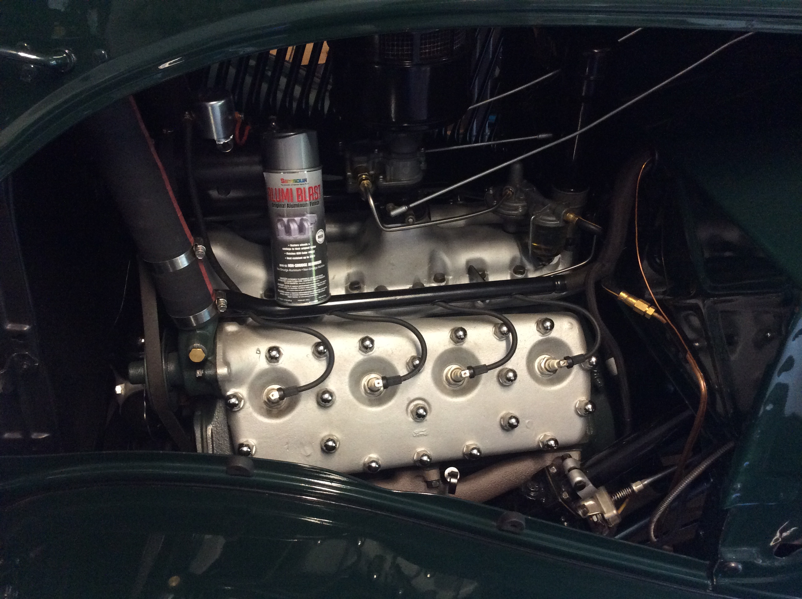

FWIW....My ‘34 (37 motor) has cast iron heads, i used Alumi-Blast coating on the heads. Compared to the original aluminum manifold, I think they are a close match and I am happy with the results...Have over 500 miles on them since coating and no problems with flaking or discoloration at all. This message was edited by Reconnoiter1 on 8-29-18 @ 2:59 PM

Great photo, thanks. Very nice finish. Think I will head that direction with my iron heads.
