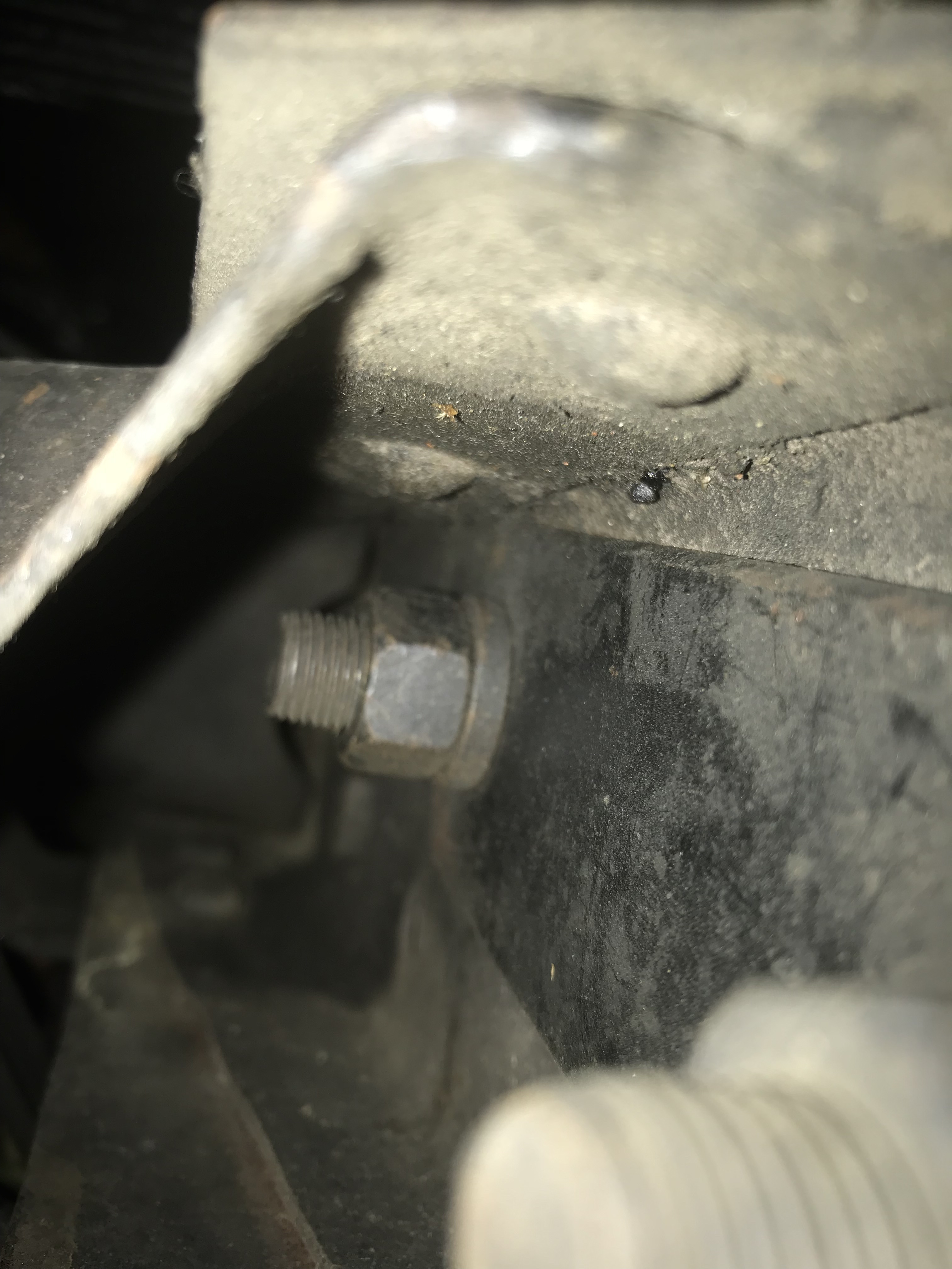

ford38v8 | -- 08-30-2018 @ 2:32 PM |
Ray, Here's a photo showing both front and rear bracket nuts inside the passenger side frame rail. With the front bolt/nut removed, I'm sure you can get a box wrench in to the inner nut. You won't have to turn the nut, just hold it while turning the bolt. Alan

Dream38v8 | -- 08-30-2018 @ 4:32 PM |
My Deluxe is not the same as yours. I can not get a camera anywhere close to take a pic like yours. Ray
Dream38v8 | -- 08-30-2018 @ 4:33 PM |
Yes, I could cut the bolt, but there is no way I could get a nut back on the new bolt. I hope 40cpe is right. Stay tuned tomorrow. Ray
ford38v8 | -- 08-30-2018 @ 10:20 PM |
Sure you can. I used my iPhone, inside the fender, in front of the frame member. Plenty of room to get a box wrench in there. You won't be able to see what you're doing, but just go by the pic and the bolt head on the outside. Alan

Dream38v8 | -- 08-31-2018 @ 3:57 PM |
Alan, thanks for the pic. I was able to locate a short open end 3/4" wrench. This allowed me to get the back nut off. Putting it back on was another matter. I am not sure how, but I was able to get two fingers back there to start threading the nut back on. The reassembly process took approx. 3 hours. Again, thanks for prodding me on. 40cpe I could not find an opening from the top. Ray ps. I ordered the front license plate holder. Ray
