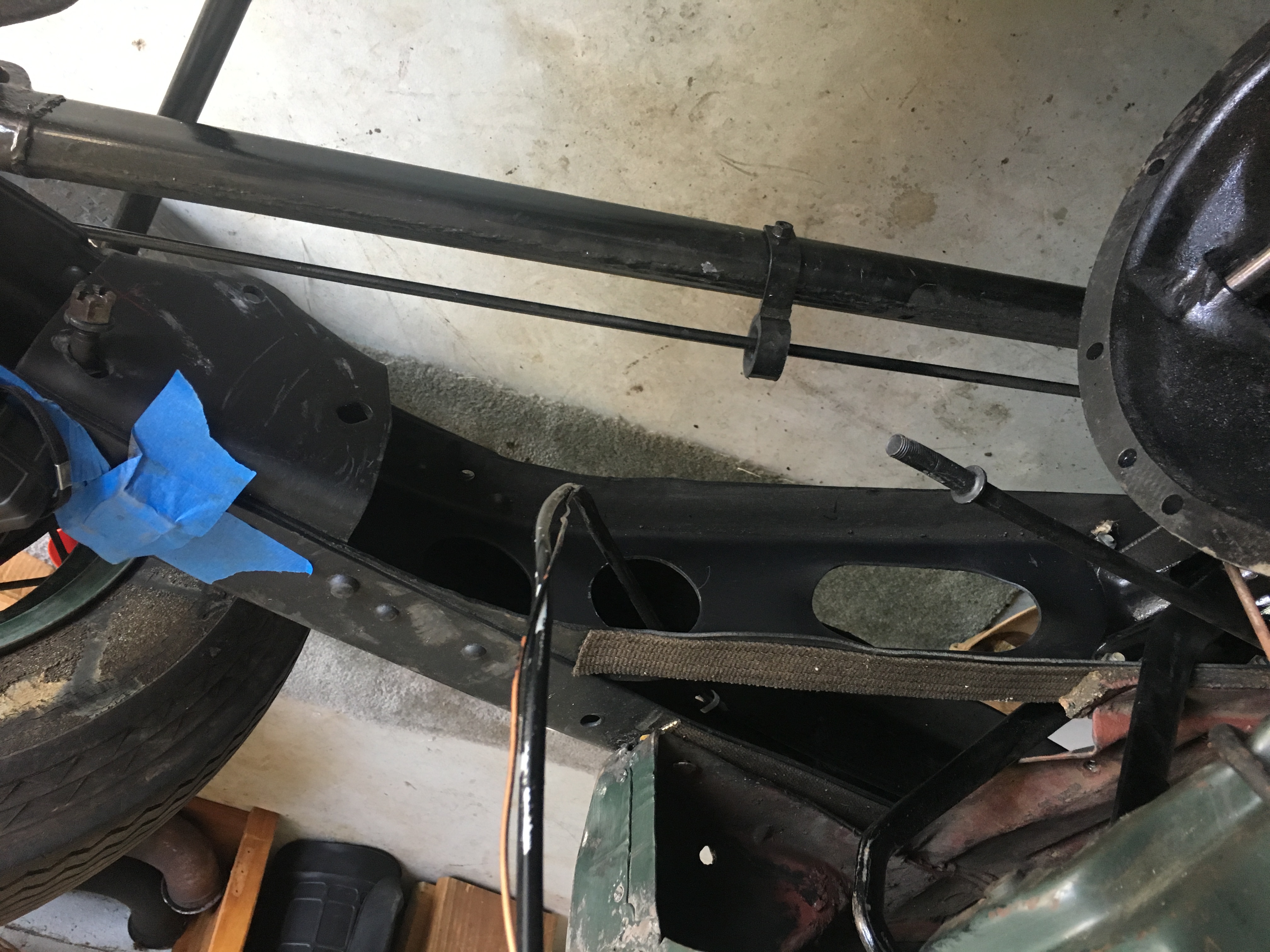

Does the fuel line exit the frame before or after the cross member then go up the firewall? The photo is what I have done but not sure now that I have done it. Greg Meiling 1935 3 Window Coupe

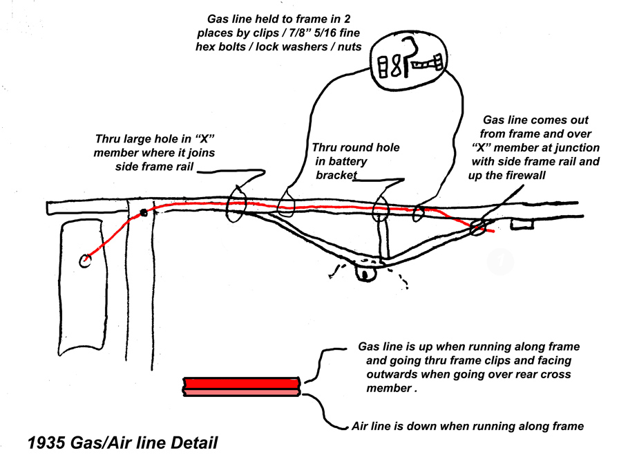

Here's a drawing that I made of the 35 gas line routing for my 35 Fords.

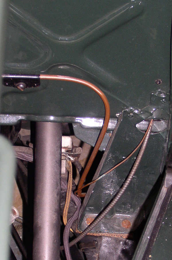

Here's some firewall detail.
