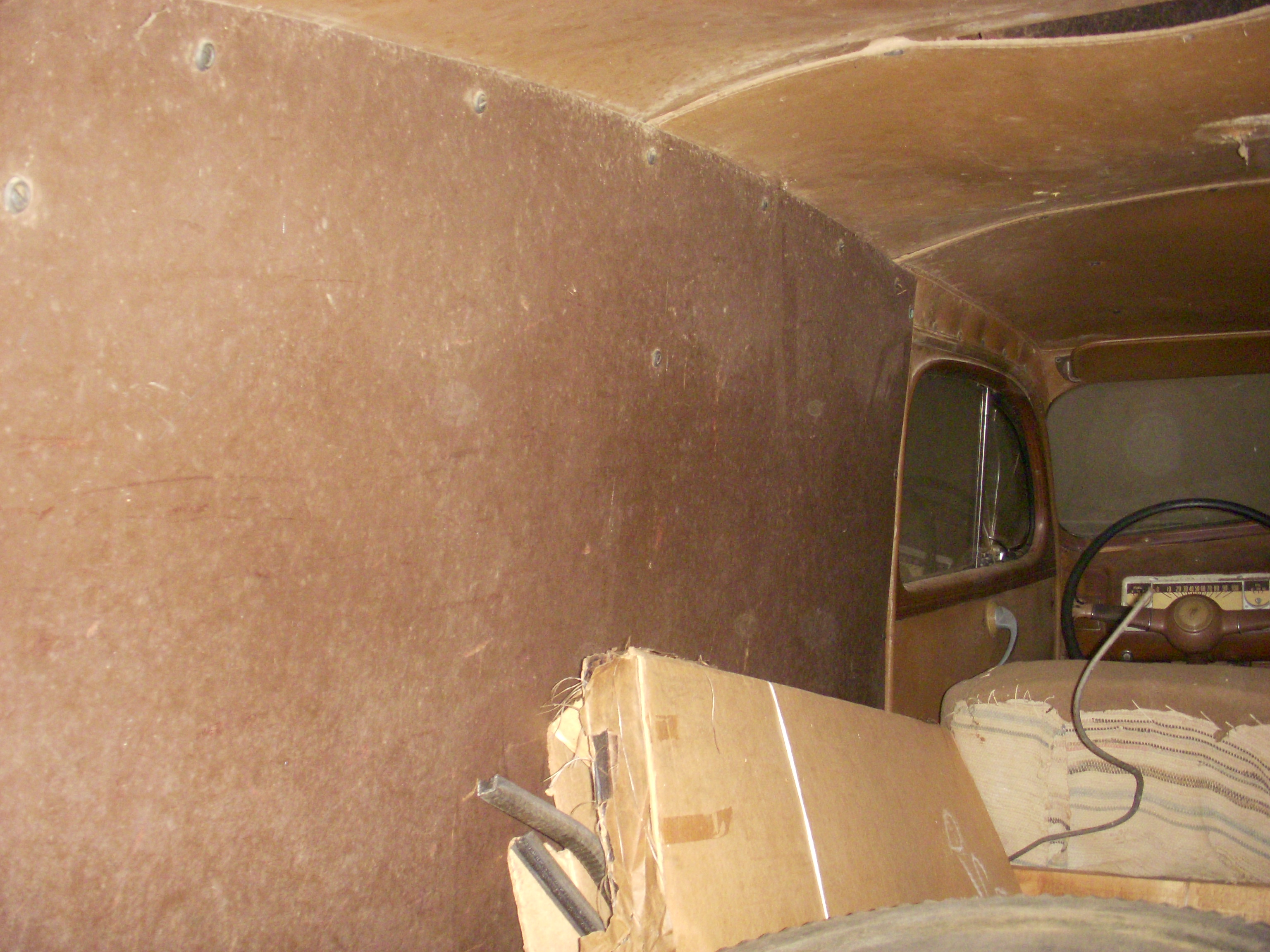

Hello, Myself and another car nut (call him Chris) are trying to figure out what the correct original headliner material and color is for a 37 Sedan Delivery. Lebaron Bonney told me they do not have any kits for this vehicle. I talked with Roy N. awhile back. I believe he told me it was a cloth material, but I am thinking it is some type of vinyl covered cardboard??? I just don't know. Thanks (pics would help too). gregg
deluxe40 | -- 07-16-2018 @ 7:39 PM |
For what it's worth, here is a '41 Sedan Delivery interior that was advertised as original.
1937sedandelivery | -- 07-16-2018 @ 8:21 PM |
Thanks. That definitely is cardboard type of headliner, Consistent with the Ford book. gregg
