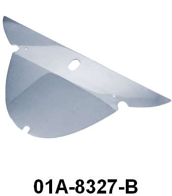

fortyford | -- 07-22-2018 @ 6:36 AM |
Gunner,do you have a upper air deflector installed on your car?This will help and most certainly will not hurt!Par t # 01A-8327-A or 01A-8327-B depending if your car is deluxe or standard.
JayChicago | -- 07-23-2018 @ 12:22 PM |
fortyford Note from his original post gunner is only having a cooling problem at stop-and-go speed, when the radiator depends on the fan to pull some air through the radiator. I can understand how that air deflector could direct more ram air through the radiator at high speed. But I can't see how that deflector could do anything to help the fan pull more air through the radiator.
