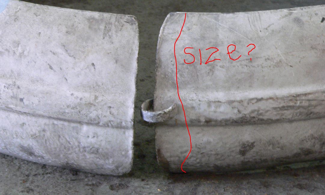

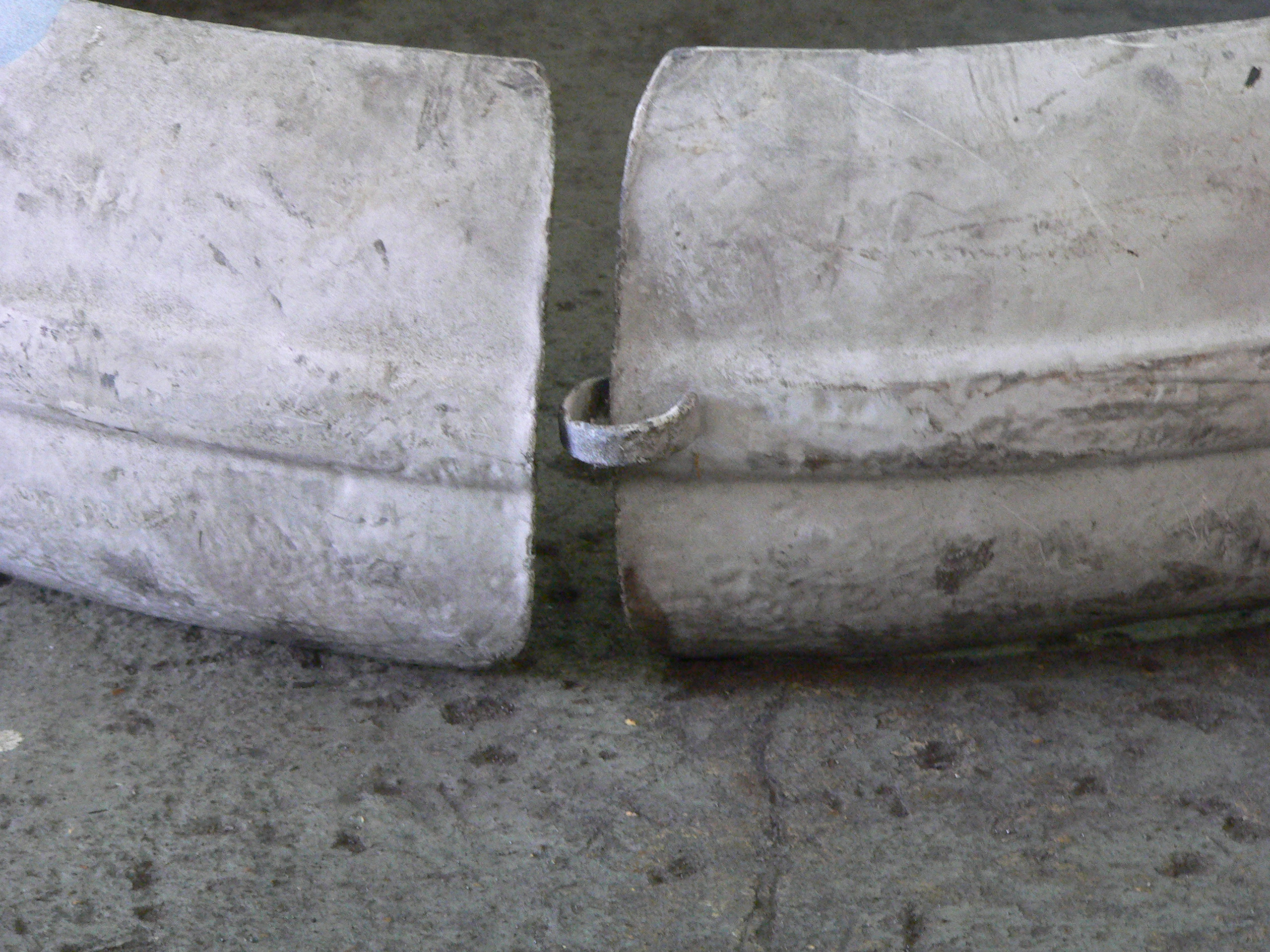

Hi 3w2 and JeffH. Thanks both for the replies. I have attached a photo of the tread cover showing the base clip. The outside diameter of the cover is 27ins. and the band width is 1 1/8ins. Hoping this is 1934 as I thought. Regards. Dave M.

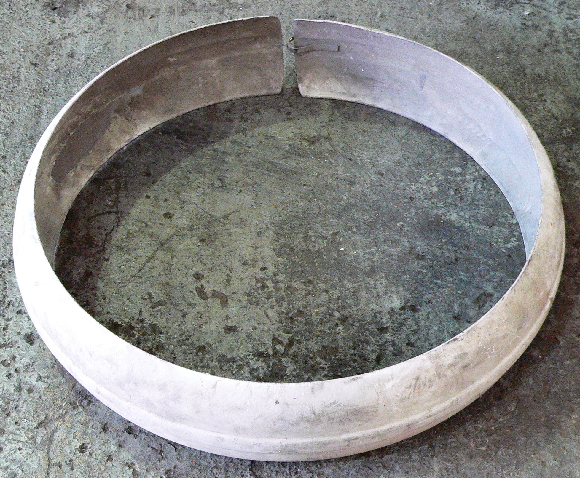

Hi Again 3w2 and JeffH. I have now attached a photo of the entire tread cover. Regards. Dave M.

I'm sure that you meant that the band width was something much wider than 1 1/8". Without that correct dimension, your photos leave open the possibility that it is a '35-'36 band.

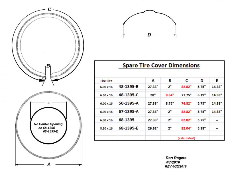

I just found a document that might save us time. It's from the fabulous Don Rogers, thank you Don sir! -VT/JeffH
3w2 | -- 07-04-2018 @ 8:08 PM |
Thanks to Don's illustration and VT/JeffH's sharing of it, if your outer band is less than 5.75 inches, then you likely have the '34 version.

Hi 3w2 and JeffH. Thanks again for all your excellent replies. I have checked against 'Don's' chart and dimensions are as follows: A = 27.38" B = 2" C = 82.82" D = 5.75" According to Don's chart this gives possibilities of it being either 48-1395-B, 67-1395-A or 68-1395. The width of the pressed radial 'hump' or 'band' in the centre (correct English spelling by the way) of 'D' is 1.125" wide which I guess is now the deciding factor. Back to you guys for the final word! I have been an EFV8CA member since 1974 and I don't remember any features on the different wheel covers ever being in The V8 Times, so this subject is becoming quite interesting! I also don't remember ever seeing a wheel cover for sale in the 'classified ads', so an indication of a fair price would be appreciated if you can do that also. Thanks again (and don't forget to cheer for England in the football 'World Cup' on Saturday). For fun, a photo of my '36 Model Y in film work being driven by actor Jeremy Irons attached. ATB Dave
3w2 | -- 07-05-2018 @ 4:27 PM |
Well, now we all know that it is not for a '34. In your earlier photo, the band looked heavily pitted, so its value on this side of the pond would rather limited as there a lot of the '35-'36 spare tire bands available in better condition. In the U.K., however, spare parts are understandably more difficult to come by, so perhaps something like 30 or 40 pounds sterling might be in order.
