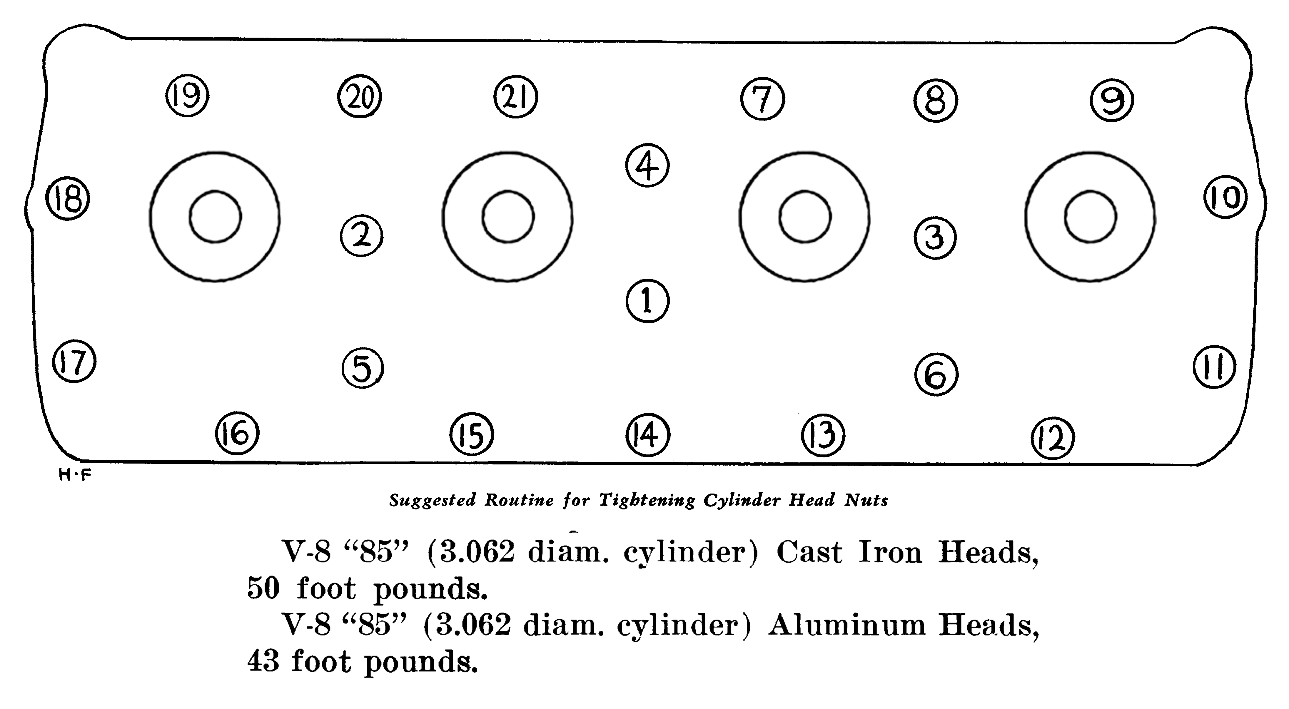

I have a 1935 Ford with a 21-bolt flthead. the passenger side head has a slight leak above the starter. I am thinking of checking the torque on the bolts. Can you tell me what the torque is? I have been told that it is 50-55 pounds.
MG | -- 06-18-2018 @ 8:53 AM |
See this link > http://www.vanpeltsales.com/FH_web/flathead_cylinderhead_torque-specs.htm
Don Rogers | -- 06-18-2018 @ 12:58 PM |
Here is the Torque specs and sequence taken from an issue of the Ford Field back in the 30's
