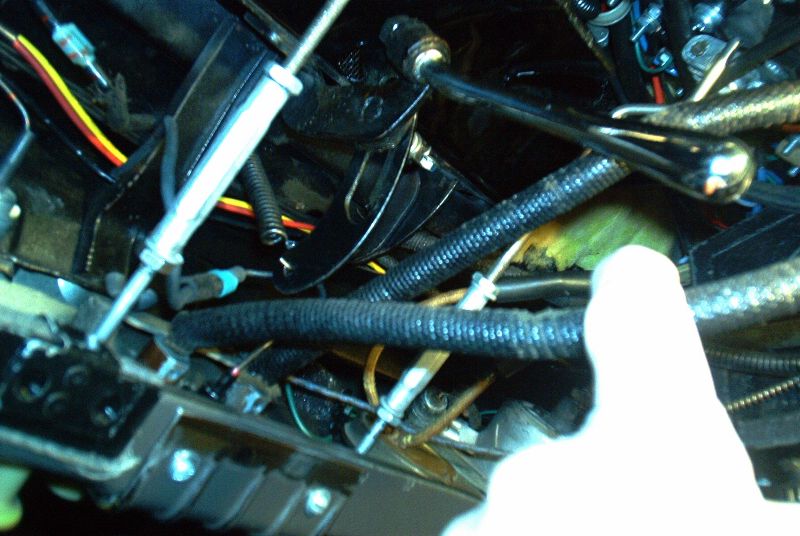

It's for a 1947 with a Holley 94. Here's a pic of the joint. It slides over the rods on each end but is not a sufficiently tight joint without a crimp or glue? or other?
kubes40 | -- 05-18-2018 @ 12:00 PM |
There was at one time just the rubber part available. I have used this type of joints too. You will have to remove the rod from the car. I have a tool that compresses fencing joints and use that. I believe if you don't have ready access to that type of tool, you could place this in a "V" block and hammer in a "crimp" of sorts with a pointed cold chisel. Another option? Solder the joint. Mike "Kube" Kubarth
