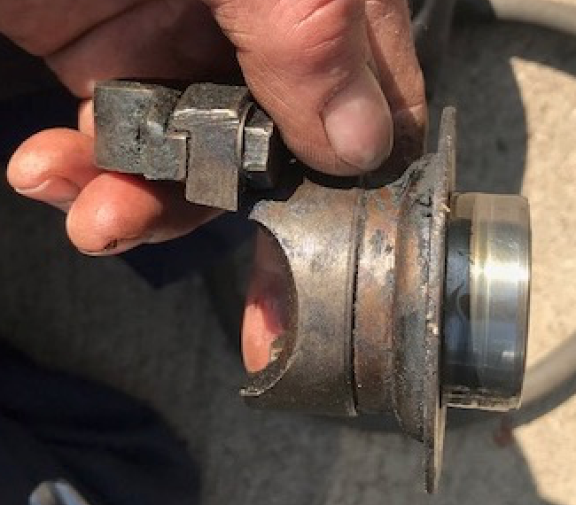

jeremyfd | -- 05-15-2018 @ 3:21 AM |
An update, this is the u-joint flange from my '51. It doesn't look stock. Any idea what it is? Measurements: Inside of Pinion Shaft 1 1/4", Outside 1 5/8".
sarahcecelia | -- 05-15-2018 @ 11:24 AM |
That's a stange one! Standard shift yokes look nothing like that! Is your car Fordamatic transmission? Regards, Steve Lee
40cpe | -- 05-15-2018 @ 2:55 PM |
That rear yoke is typical of those used by Ford from'49 up through at least the mid-50s.
sarahcecelia | -- 05-15-2018 @ 5:07 PM |
I don't know about that yoke being used in 1950 cars. I have two (2) 1950's right now, and when I was 18 I had a '50, and none of them had a rear yoke that looked like that one. One of mine that I have now is an early '50 (4 blade fan) and so was the one I had at 18, the other, my Crestliner, is a later '50 ( 3 blade fan.) I built these last two cars I mentioned.My rear yokes look nothing like that one. Strange?? Regards, Steve Lee

40cpe | -- 05-15-2018 @ 7:36 PM |
Well, I respectfully disagree. That differential yoke did come on '50 models. And it doesn't fit the output of the transmission and has nothing to do with the drive shaft, except the rear u-joint connects to it. Here is a link to one, showing it fits '49-'55. http://shoebox-central.com/1949-1950-1951-1952-1953-1954-1955-ford-rear-axle-differential-yoke
jeremyfd | -- 05-16-2018 @ 1:38 AM |
Yes it's the automatic transmission.
