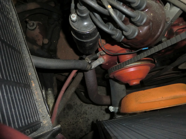

Should be a double pulley on the crankshaft to accommodate the two belts. See attached picture....

I do have a two belt pulley and plan on using two belts but when I got my crankshaft back from the machine shop there must have been a crankshaft extension on it because the pulley is now about 1 1/4 inch short and does not line up with the other pulleys.
