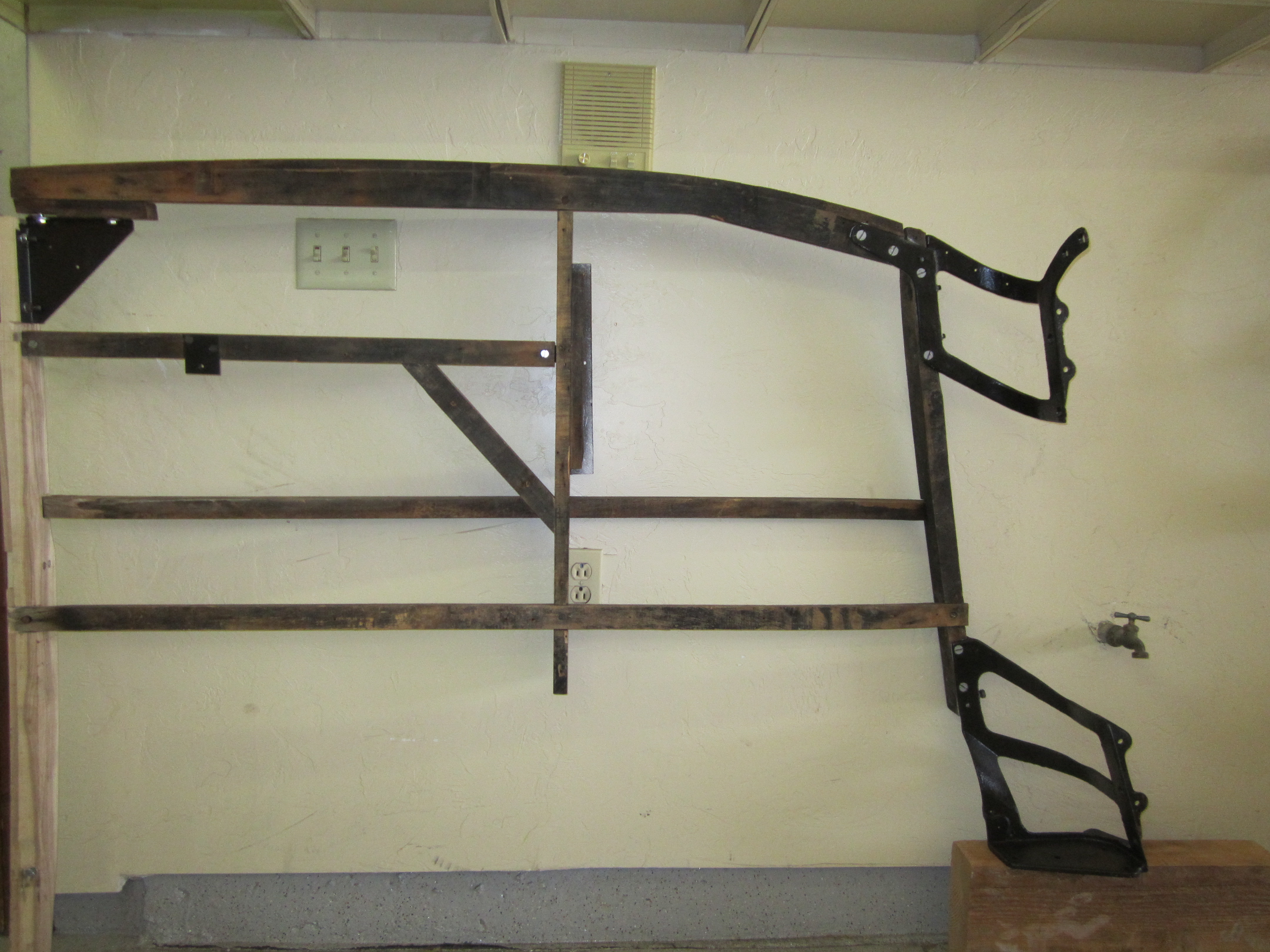

Hello, My 37 Sedan Delivery has a fair amount of wood in the rear interior. Aside from the floor and quarter panel frame structure, there are some wooden cross members. Question: do these wood pieces have Ford part numbers? If so, where can I get that information? Dimensioned drawings would be awesome to have also, but that is pretty remote. Thanks, Gregg

40 Coupe | -- 04-24-2018 @ 4:06 AM |
The wood you show in your photo looks very good if you need to replace some it is amazing what a CNC router can do. The computer technology is amazing. Stop by your local woodworkers store and inquire. Often times the employees own their own equipment and will do projects for customers.

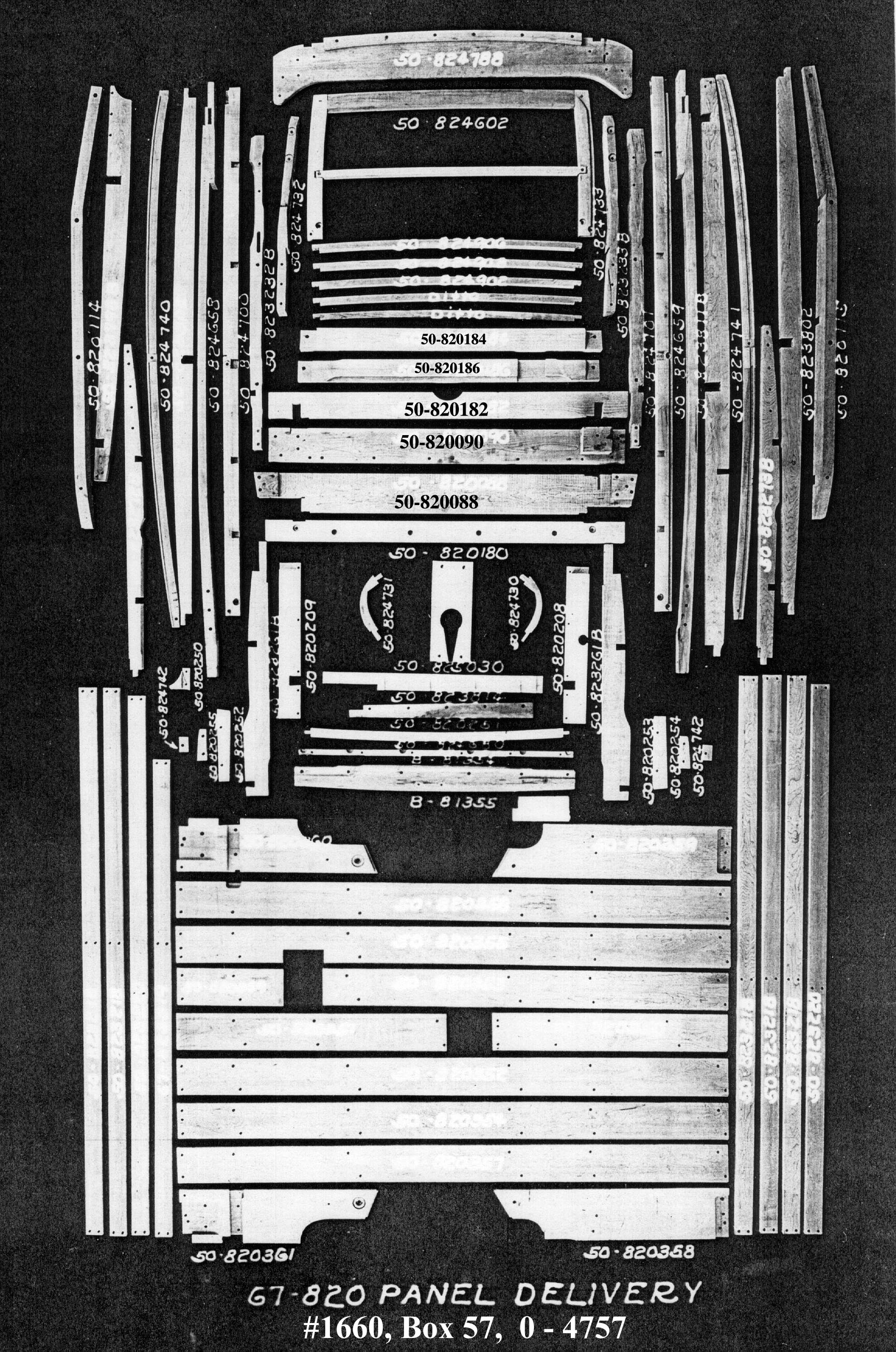

Don Rogers | -- 04-24-2018 @ 9:53 AM |
Greg, I found a wood layout photo of a 36 panel delivery in the Benson Ford Research Center years ago. It came from Accession # 1660 Box 57. There may be similar photos for your sedan delivery in that grouping. The photo was nice because it gave individual part numbers for each piece of wood. Once you have the part numbers, you can look up each individual piece. Here's my photo of a 67-820 panel delivery. Don Rogers ps If you are going to the Grand National V-8 Meet in June, you could slip over to the Archives and take a look.
1937sedandelivery | -- 04-24-2018 @ 12:13 PM |
Hey Don, Wow, that is a great pic of lots of wood. I see that they do assign p/n's to all the wood pieces. I have been looking for excuses to take a trip there. Thanks for sharing the info and picture. gregg
