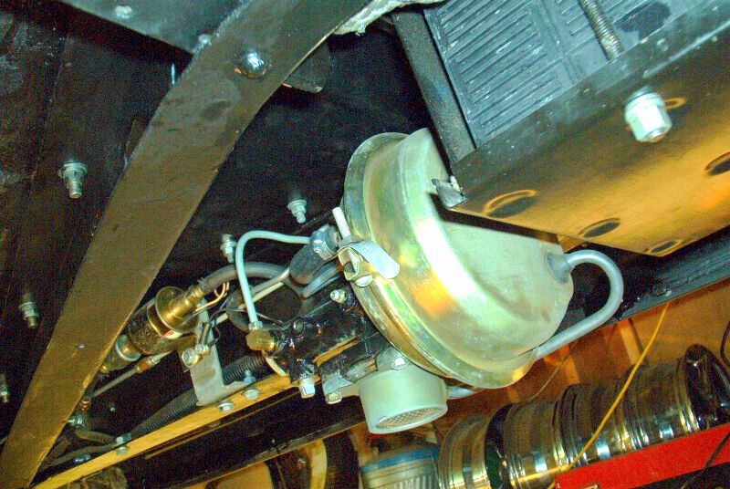

flatheadfan | -- 03-04-2018 @ 1:07 PM |
Assuming that the brakes are mechanically "sound." I would add a vacuum booster. A '54-'57 Ford vacuum booster is an easy add-on using existing frame holes. I have done this to my '35 ('47 brakes), and have some super stoppers that rival my newer daily drivers. Tom
