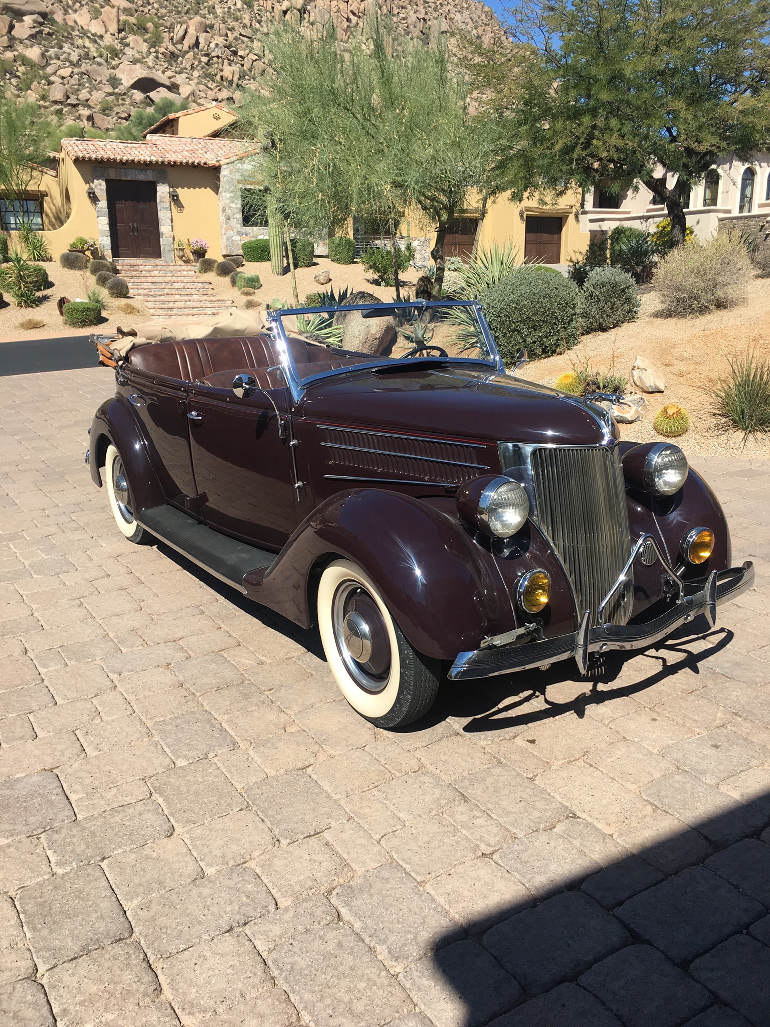

My 1936 Ford Phaeton needs some touch up on the paint job. It is a dark maroon does anyone have any knowledge of paint formulas or a paint supplier I could speak with
