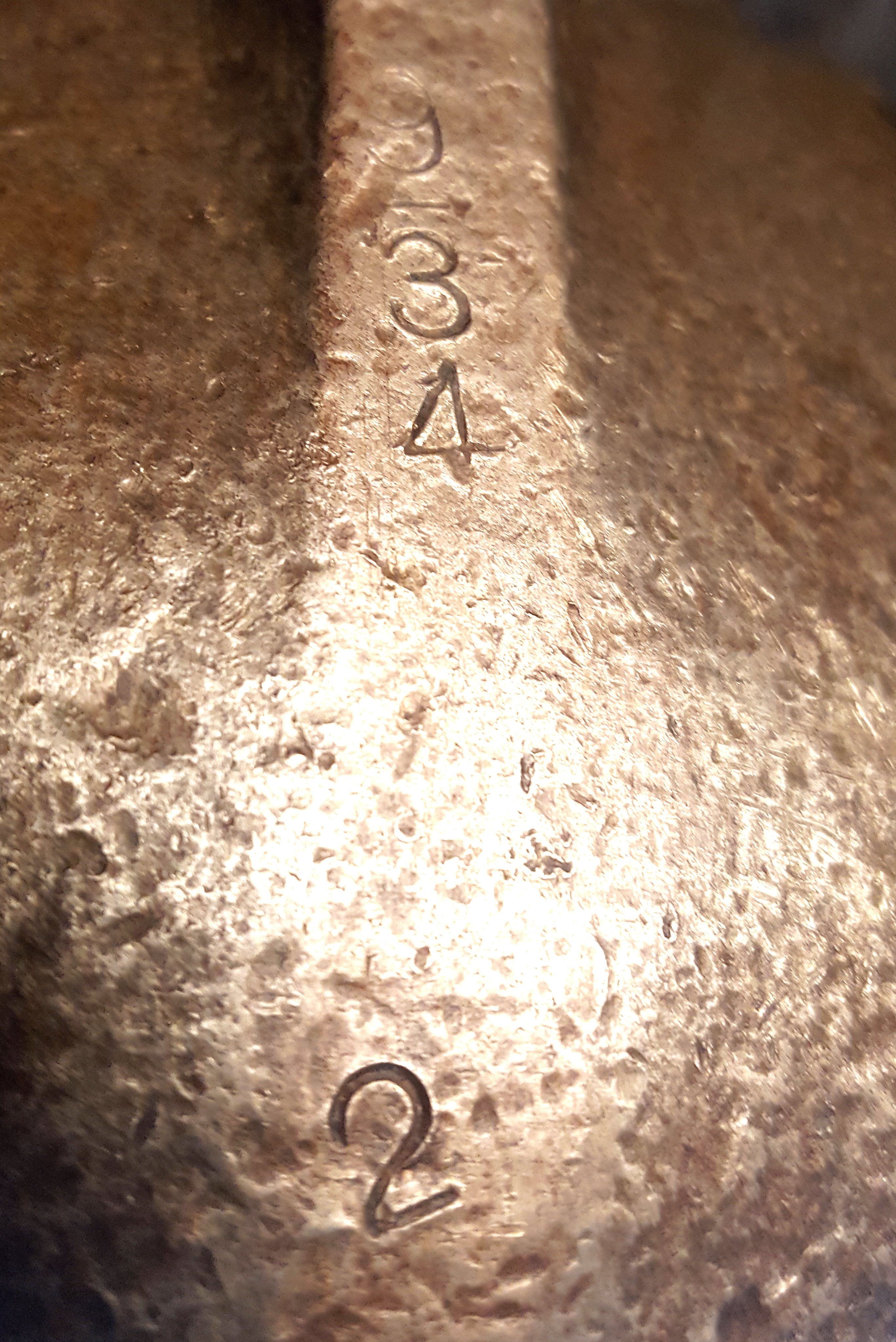

ibshane | -- 01-31-2018 @ 2:40 PM |
This is the only numbers I could see stamped into the diff. housing. Looks more like it would be a date? 9 - 3 4 2
40cpe | -- 01-31-2018 @ 6:17 PM |
34/9=3.7777 (3.78) I don't know what the 2 is.

FrankM-RG5 | -- 02-02-2018 @ 7:20 AM |
They just stamp the number of teeth on each gear. The earlier answer about turning the engine is more correct because over the years who knows what went into these.

woodiewagon46 | -- 02-02-2018 @ 7:55 AM |
Frank, brings up a good point. Perhaps the rear end was rebuilt at some time and the stamped "two" is a mark of who the mechanic was that worked on the rear.
1934 Ford | -- 02-03-2018 @ 6:44 PM |
The 9 34 stamped in the rearend housing means 9 teeth on the pinion gear and 34 on the ring gear. Divide the 9 into the 34 = 3.777778, which means you have a 3.78 gear. If it says 9 37 (37 divided by 9= 4.11111) or called a 4.11 First number is turns of the pinion gear, second number is turns of the ring gear or axle. The lower the number the faster the top speed, the higher the number the quicker acceleration. 1934 Ford's since 1972
