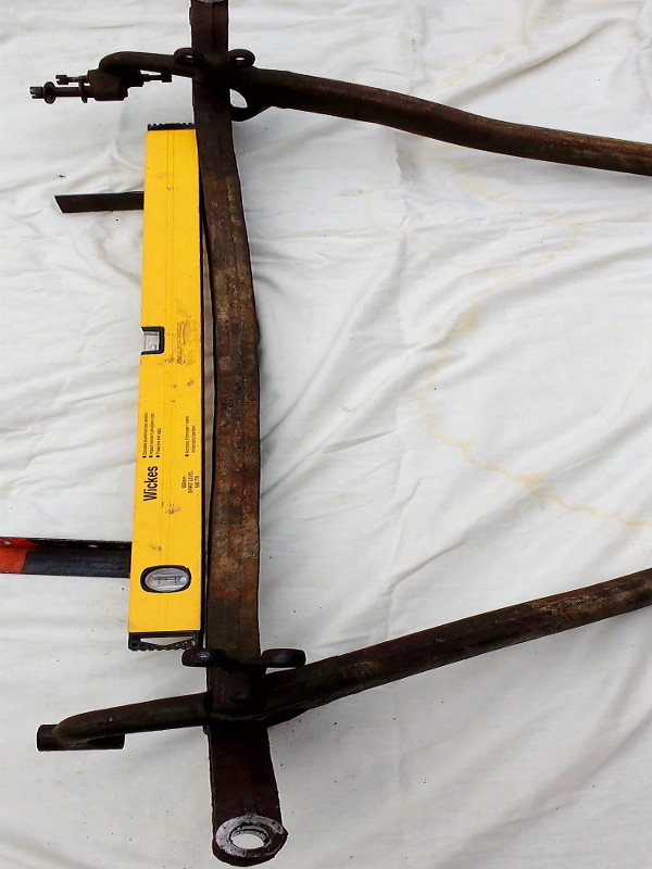

Greetings All I am restoring a 1942 Fordor, and I have a query for all the front end specialists out there. I have pulled the front axle off the car, and have noticed that the beam axle appears bent/bowed rearwards. ( check photo ) I really don't think Henry built them this way - I suspect the beam has taken a few hits in days gone by. However, as this is my first early Ford resto, what do I know! Many thanks. MT

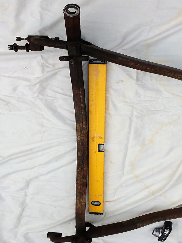

Another photo of the axle
woodiewagon46 | -- 01-14-2018 @ 8:06 AM |
My first suggestion is to try to locate a NOS axle. Your axle can be straightened by a front end shop that does truck work. It is not just taking the bend from the mid section of you axle, but the king pin bosses should also be checked for caster and camber. That axle took a pretty good hit sometime in it's life.
Mtpockets335 | -- 01-14-2018 @ 10:34 AM |
Thanks Woodie 46 Truck repair shop is a good suggestion, trucks still use beam front ends with King pins, so those fellas should have the gear. In the meantime, I will start the search for another axle - that will be a nice sized lump for shipping to Blighty!
