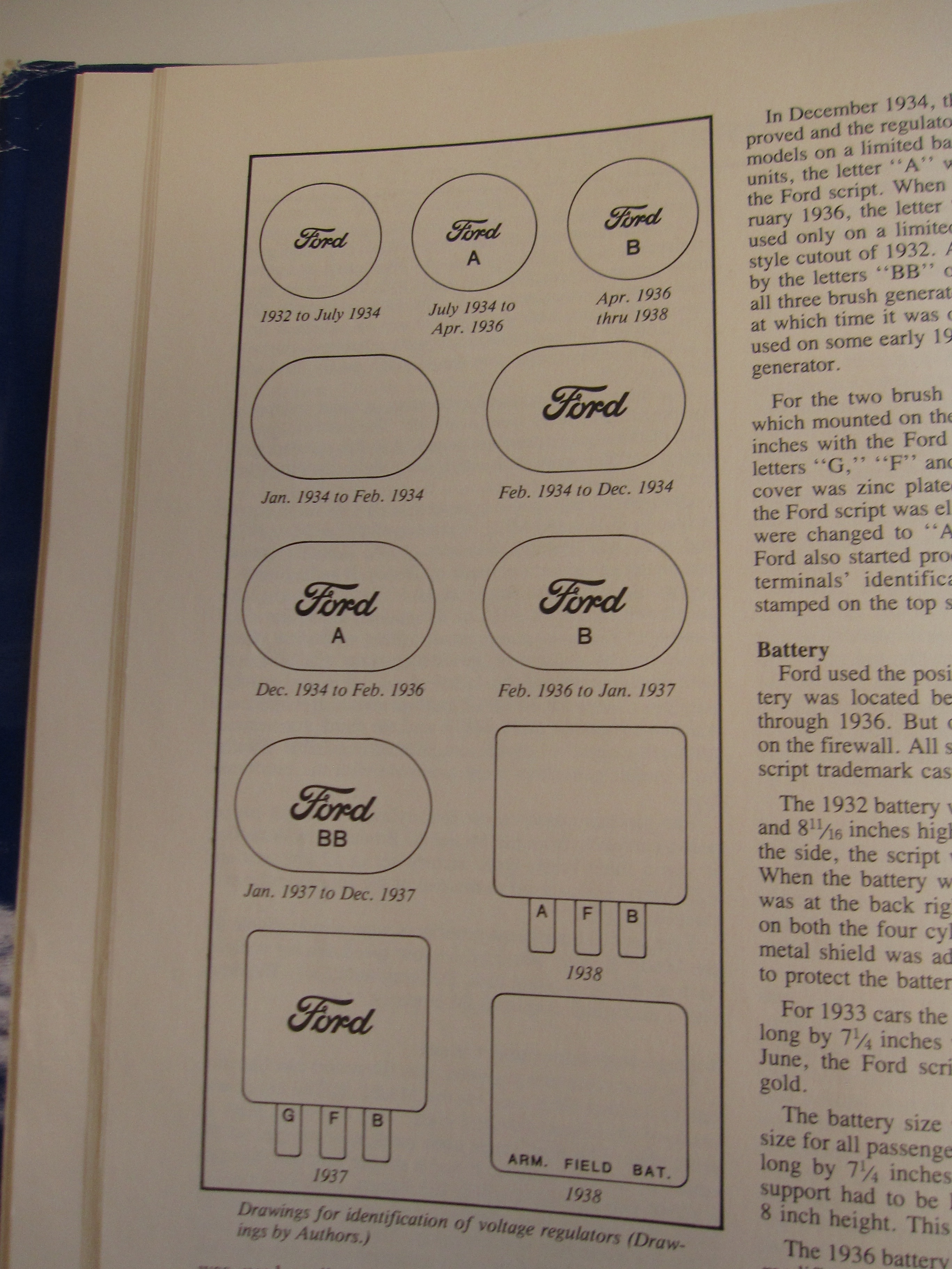

Can anyone tell me if the original oblong Generator Cutout for the 36 Fords that have Radio's had the Ford name on the top? Or if not what if anything did they have stamped on them? Jerry
cpipp01@aol.com | -- 12-14-2017 @ 10:44 AM |
Hi this may help it is out of the book The Early Ford V8 As Henry Built It see attached.

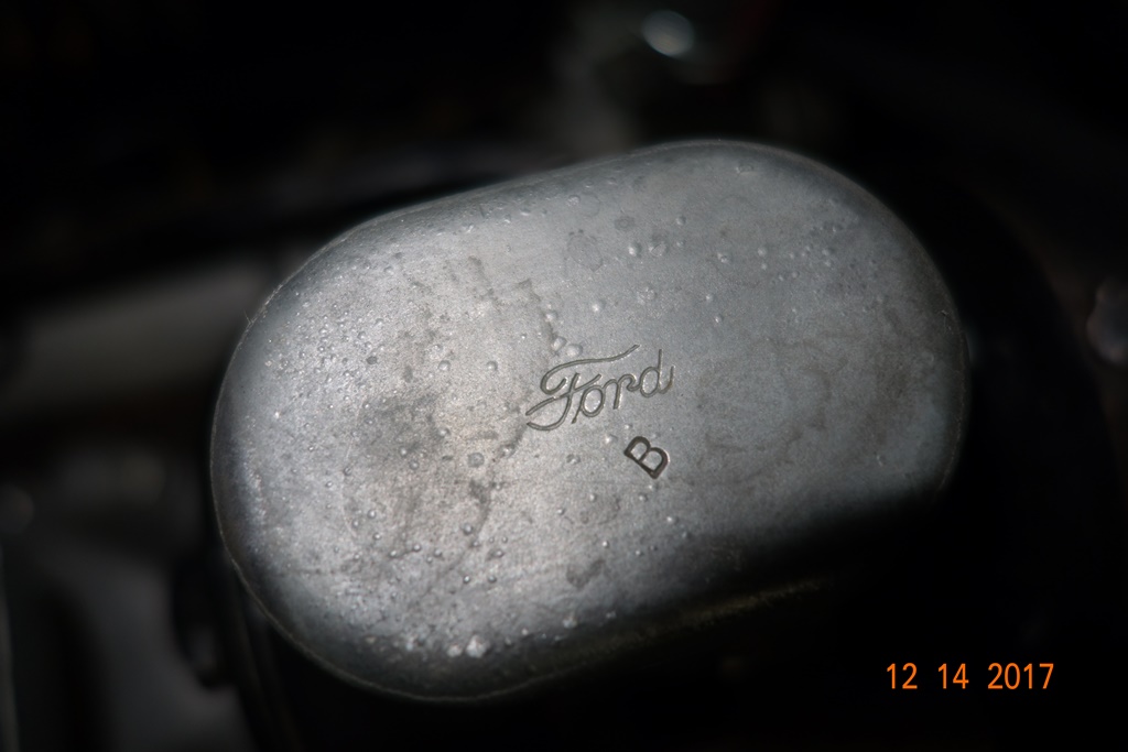

Bob56 | -- 12-14-2017 @ 3:33 PM |
here is what the top of mine looks like
