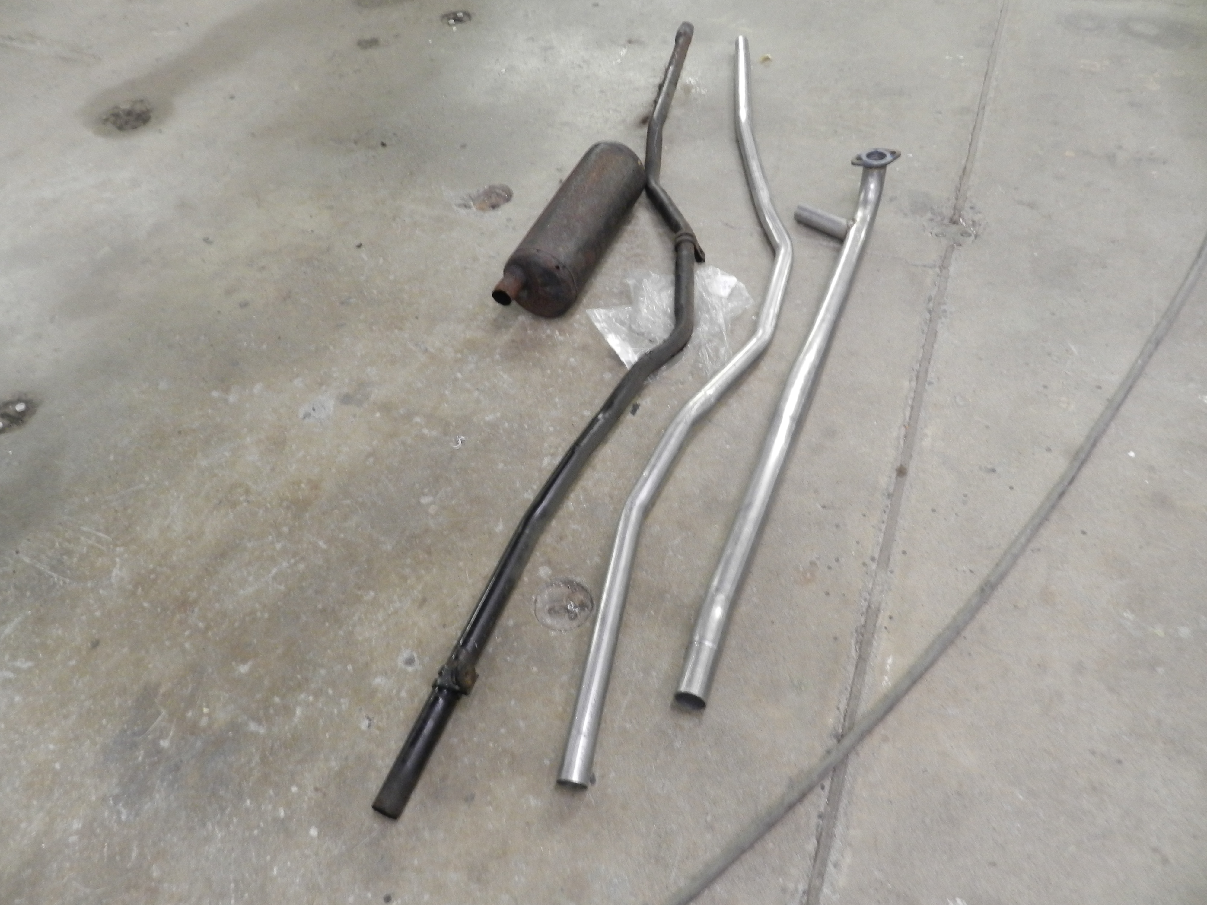

We are replacing the stock exhaust system on a 1936 Ford. What is the best way to install the exhaust pipe from the engine to the muffler in one piece. http://www.classicgaragellc.com/1936-Ford-3-Window-Coupe-Brett-Sargent/ Thank You, Brad 208-755-3334
pinnsky | -- 11-27-2017 @ 4:56 PM |
Start at the front, feed the pipe through the front cross member and install the gasket and tighten the bolts loosely to the exhaust manifold. Then add the muffler and work your way to the rear. Once you get it installed loosely, align it and tighten it up.
