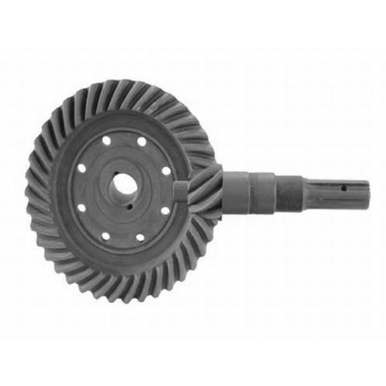

I am wanting to get my '37 Touring Sedan a little higher hiway speeds without taching out my Flathead. From the research I've done it soundslike my best options are to either swap out my OEM tranny for something like a T5..., or have my rearend gearing changed to somewhere in the neighborhood of 3:25 Ratio. Also.., are the original Banjo differentials a good enough unit to merritt rebuilding..., or should I think about retrofitting a modern differential? I would like to keep it as stock as possible.., or at least not change anything that can not be changed back to original! (It will never be turned it into a HotRod while I own it) I just want to make it more roadable.

Shane, A Ford flathead will not "tach out'. It will develop valve float before any danger of red lining could occur. A 3.25 x 1 ratio is, in my opinion, much too low a ratio for street use. So low, in fact, that you'll need to replace clutches more often, just trying to get across an intersection. 3.78 x 1 is the optimum ratio for multi purpose driving. If you live on the flatlands, no hills to speak of, and anticipate high speed highway driving, then you may consider a 3.54 x 1 ratio. Both these ratios are readily available without going to a "new" set from Speedway. First, though, you nee3d to discover the ratio you are running now, as you may very well have the gears you would choose anyway. If not 3.78, you may have 4.11, which is good for fast off the line, but not so good on the highway. Oh, and yes, the Ford banjo is a good choice to rebuild. Alan This message was edited by ford38v8 on 11-16-17 @ 7:54 PM

I replaced the 4:11 rear end in my '34 Sedan with 3:54's and now wish I would have selected 3:78's instead. As ford38v8 said above > "3.78 x 1 is the optimum ratio for multi purpose driving."....
len47merc | -- 11-17-2017 @ 2:45 PM |
I will weigh in and agree with Alan's reply and add to his comments with the following two paragraphs for use our V8's with overdrive or not: 1st - 3.54 is perfect for ALL flat-land driving ONLY. 3.78 (which is what I have) is ideal for flat-land, rolling hills, foothills and moderate mountain driving. 3.78 will get you up Pike's Peak in 1st gear but is not ideal for only mountainous terrain. Install an OD with either of these and on intermittent hilly terrain you will be kicking it in and out of OD to the point of annoyance. 2nd - who in their right mind wants to drive a STOCK EFV8 above 55-60 mph anyway? My 3.78 with 710 Firestones turns ~2,500 rpm at 60 mph actual per GPS which is right in the middle of the torque curve for a 59AB. Installing a 30% OD will reduce RPMS to ~1,800 which is outside of the torque curve - it will work on flat land but upon realizing the first modest incline it'll be time to kick it out. I've driven it at higher speeds just to see what it would do and believe me, any even minor emergency maneuver required above those speeds will not end well for any STOCK vehicle with STOCK suspension components. Steve

My 40 I just rebuilt a rearend. Using 3:54 gears. It had 3:78 in it. Now it goes down the road with ease.. we have another 40 with 3:54 in it also. No problem keeping up with traffic at 60 or 65. Also the speedo gear has 18 teeth on it for the 3:54 ratio. Happy cruising...
