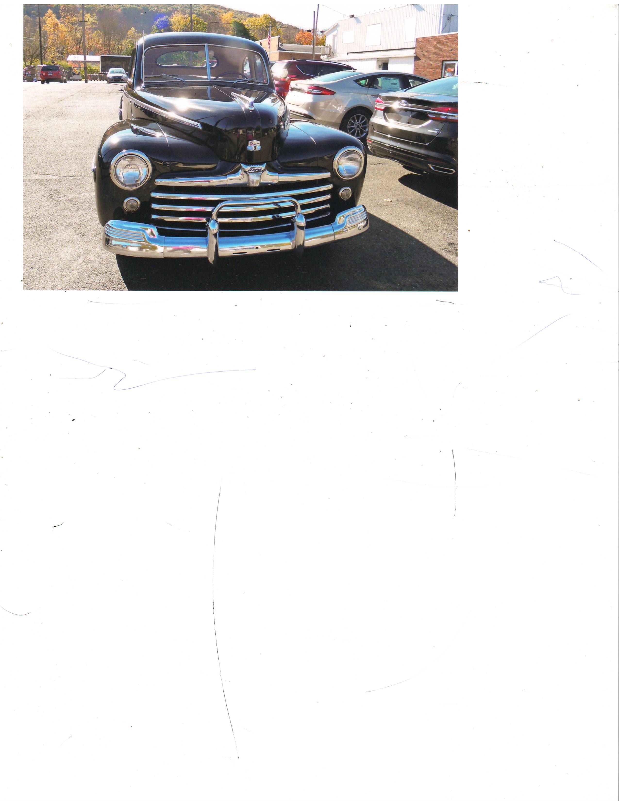

1942deluxe | -- 11-16-2017 @ 4:02 PM |
Pictures of my 1948 Ford "short door" business coupe if they'll post.

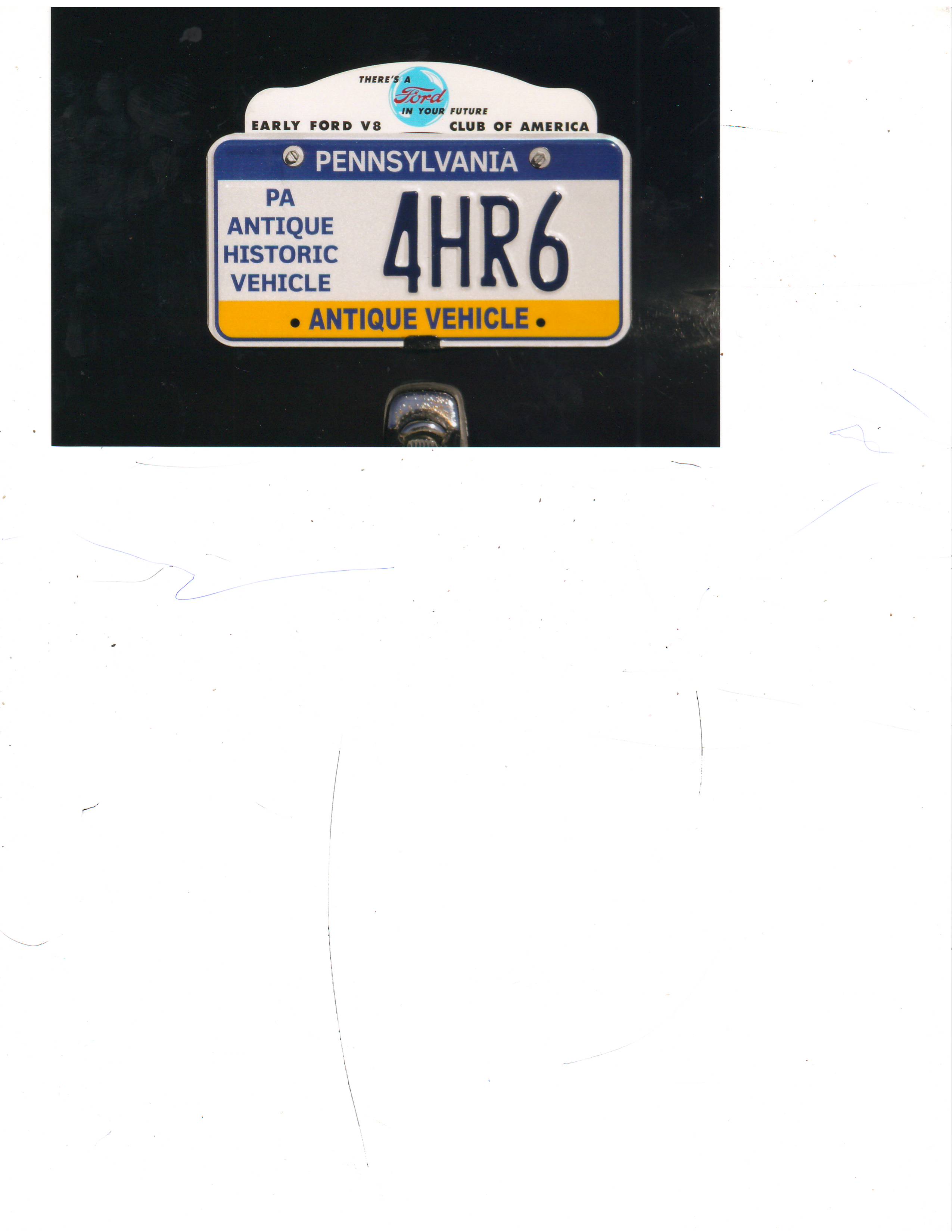

1942deluxe | -- 11-16-2017 @ 4:03 PM |
Another try.

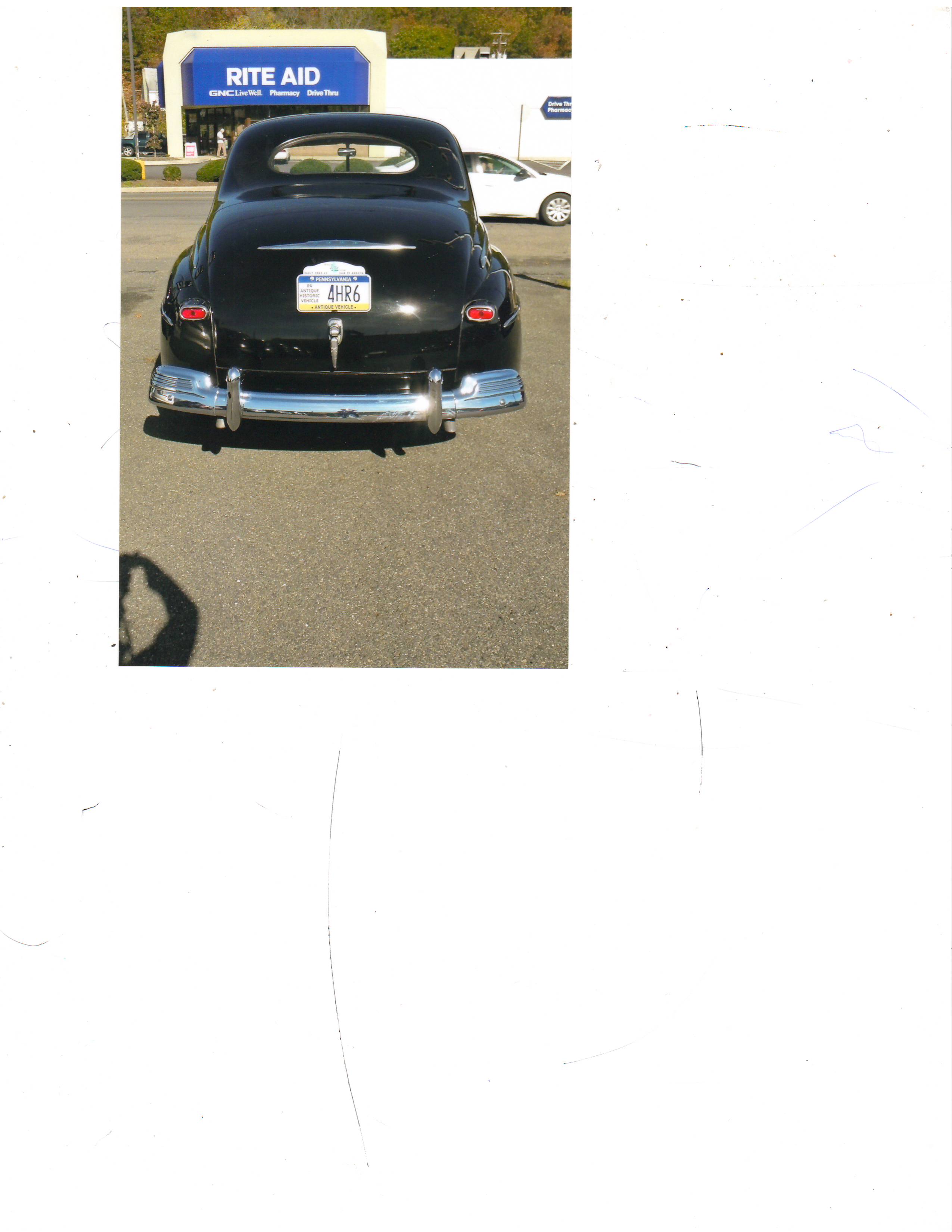

1942deluxe | -- 11-16-2017 @ 4:04 PM |
Another shot.

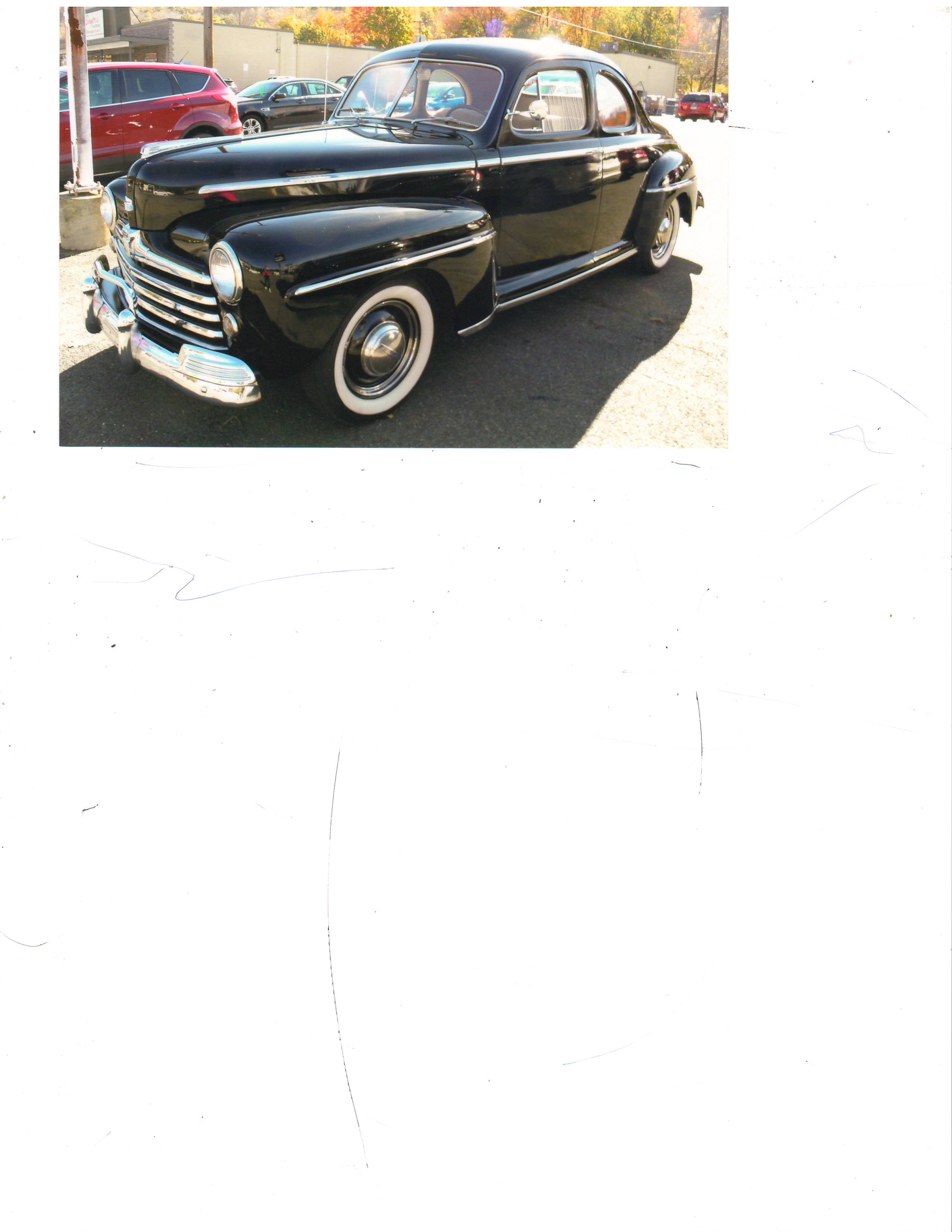

1942deluxe | -- 11-16-2017 @ 4:05 PM |
Another shot.
