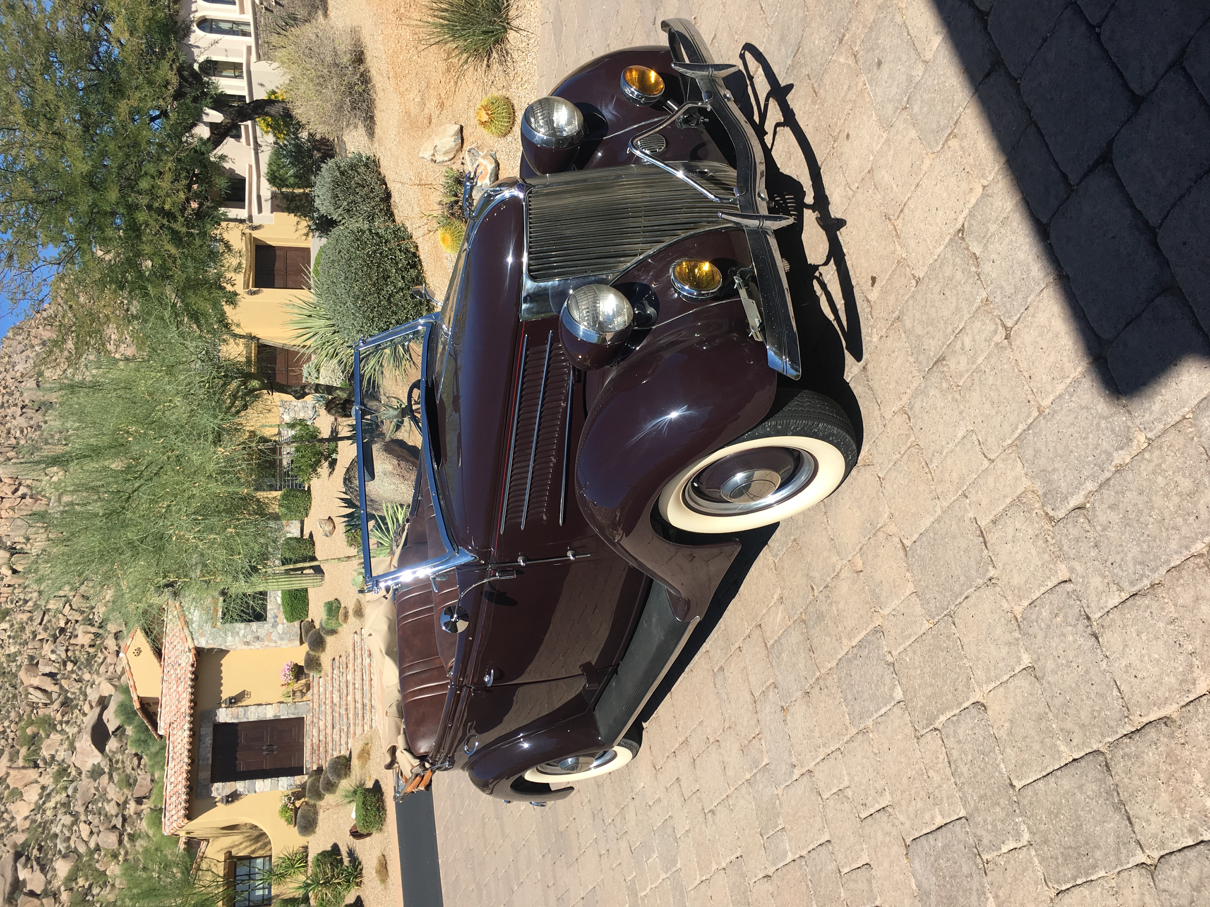

I recently purchased a 1936 Ford Phaeton I did not do my homework and just discovered that a rod is knocking. I am being told that a rebuilt engine is in order and I am looking at a price tag of about $10,000 Is there a market for rebuilt flathead V-8's that might be an option to rebuilding this one? The car is located in Scottsdale Arizona Any other thoughts or options would be appreciated
