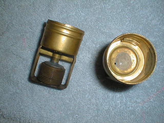

drkbp | -- 11-09-2017 @ 5:43 AM |
It may be time for new hoses. The thermostats I have are like the attached photo. Not a tube exactly but totally inside the hose. Of course, they help the car warm up but one of the best features of this style is that it cuts down on the flow of water from the water pumps. I don't have a hot water heater on my car but if you do, better to have them up near the radiator. I had a picture of the early thermostats somewhere but I can't find it. I believe the factory started using them in '33.
carguy | -- 11-15-2017 @ 9:11 AM |
drkbp said "The thermostats I have are like the attached photo. Not a tube exactly but totally inside the hose. Of course, they help the car warm up but one of the best features of this style is that it cuts down on the flow of water from the water pumps." Is cutting down the flow of coolant really a good thing? I am considering installing the the3rmostats than Robert Shewman is offering in the V8 Times because he says that his do not restrict the coolant flow. I'd like to hear some other ideas on the value of high current flow. Bill Brown '34 Cabriolet
