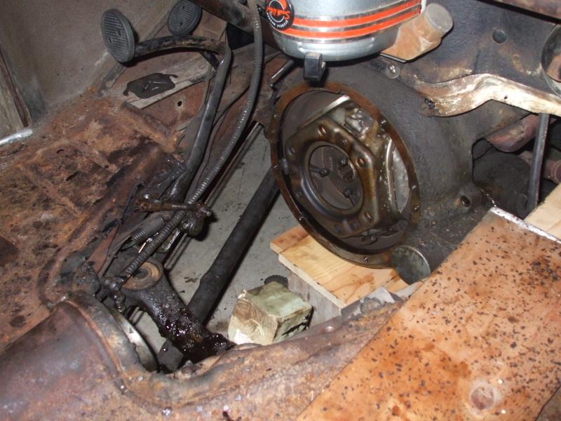

Carguy...attached is the procedure for removing the transmission from the Engine & Chassis Repair Manual. Kerry

I had to jack up the motor a bit to allow the transmission to clear. Hope this helps.

#1. Remove the front seat bottom & floor mat and floor boards. #2. Take the shift lever tower off the transmission #3. Jack the rear end up, support with jack stands on the frame rails, in front of the rear wheels. #4. Jack up the differential and remove the rear wheels. #5. Remove the 4 nuts on the U-Bolts holding the spring to the rear cross member. #6 Loosen & remove all the bolts all holding the transmission to the bell housing. #7 Take all the bolts out holding the Torque tube to the back of the transmission #8 Disconnect the rear brake rods from the pedal assembly, plus the had brake cable. #9 Here is where you need help, Put a strap under the front of the torque tube for your helper to hold, while you do #10 & 11. #10 Then lower the whole rear end. (If the car is not high enough off the floor to clear the spring, take the jack out and roll it on the brake drums. #11 Roll the entire differential & torque tube back separating them from the transmission. #11. Now slide the transmission back off the crank shaft and lift out of the hole in your cars floor. As previously mentioned you may have to jack up the rear of the engine. 1934 Ford's since 1972 This message was edited by 1934 Ford on 11-7-17 @ 7:43 AM
