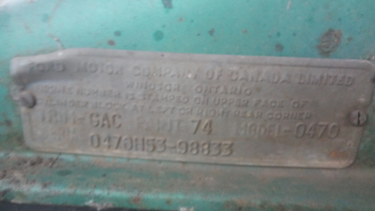

Yokomo99 | -- 10-19-2017 @ 6:21 AM |
The tag on the firewall in the engine bay has the number 74 beside the paint tag Be sure to check out my YouTube pages at: https://www.youtube.com/user/MatthewBergin1 https://www.youtube.com/channel/UCJCdOfmXtM8xO9nXeQ-iSQQ

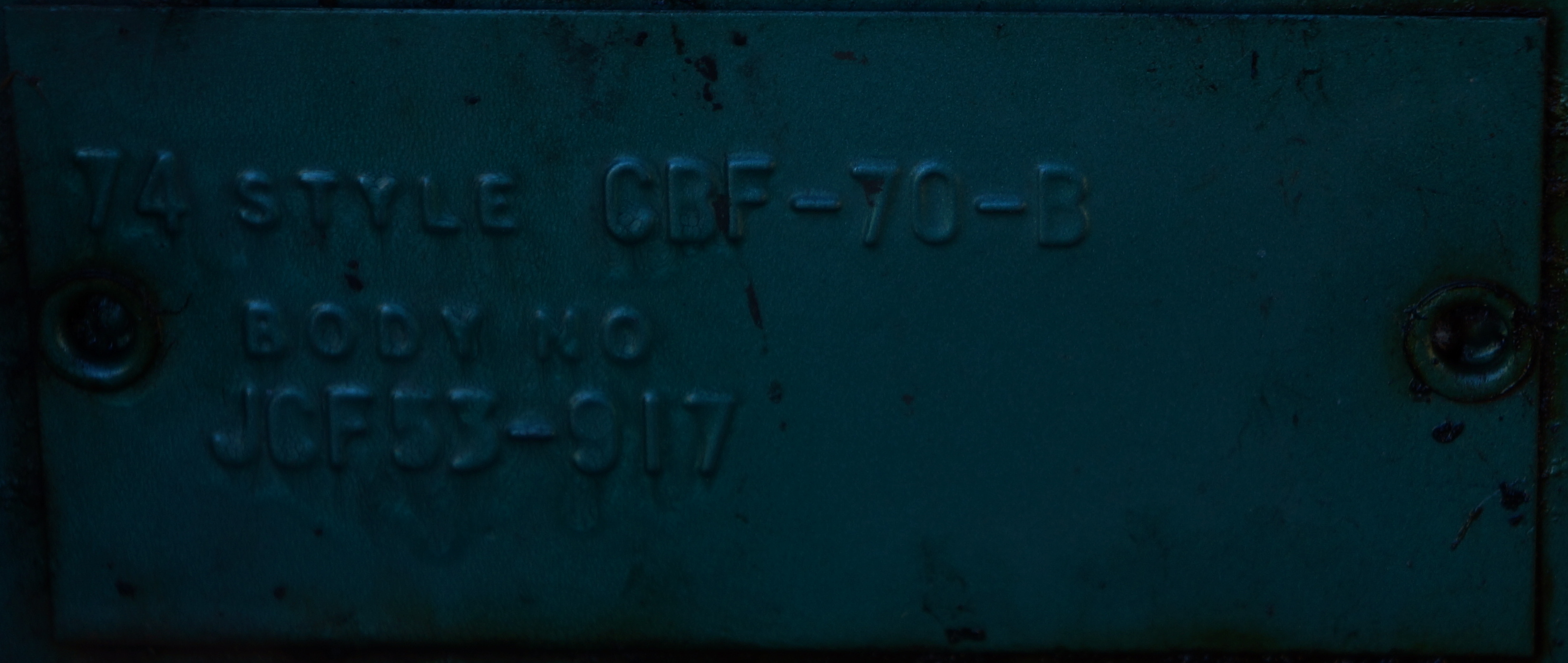

Yokomo99 | -- 10-19-2017 @ 7:25 AM |
Here is a picture of the A pillar tag as well. Matt Be sure to check out my YouTube pages at: https://www.youtube.com/user/MatthewBergin1 https://www.youtube.com/channel/UCJCdOfmXtM8xO9nXeQ-iSQQ This message was edited by Yokomo99 on 10-19-17 @ 9:59 AM
Grant | -- 10-20-2017 @ 6:31 AM |
The code CBF-70-B identifies your car as a Ford of Canada Customline Tudor. Serial number 0470H53xxxxx translates as: 04 Ford Custom 70 Tudor H L.H.D. Home Office 53 Model Year xxxxxxx Consecutive job number at assembly plant The paint code 74 is curious for a '53. My September 1954 Ford of Canada '49 to '54 catalogue (566 pages) shows 74 as a 1952-only number, used for both Raven Black and Vassar Yellow. It may be that the vehicle had a special order paint job when new.
TomO | -- 10-20-2017 @ 8:58 AM |
the color on the firewall looks like Cascade Green. This may have been a Spring Color. http://images.tcpglobal.com/chips/1953-Ford-pg07.jpg?_ga=2.112269251.655637474.1508514795-968164132.1508514795 Tom
