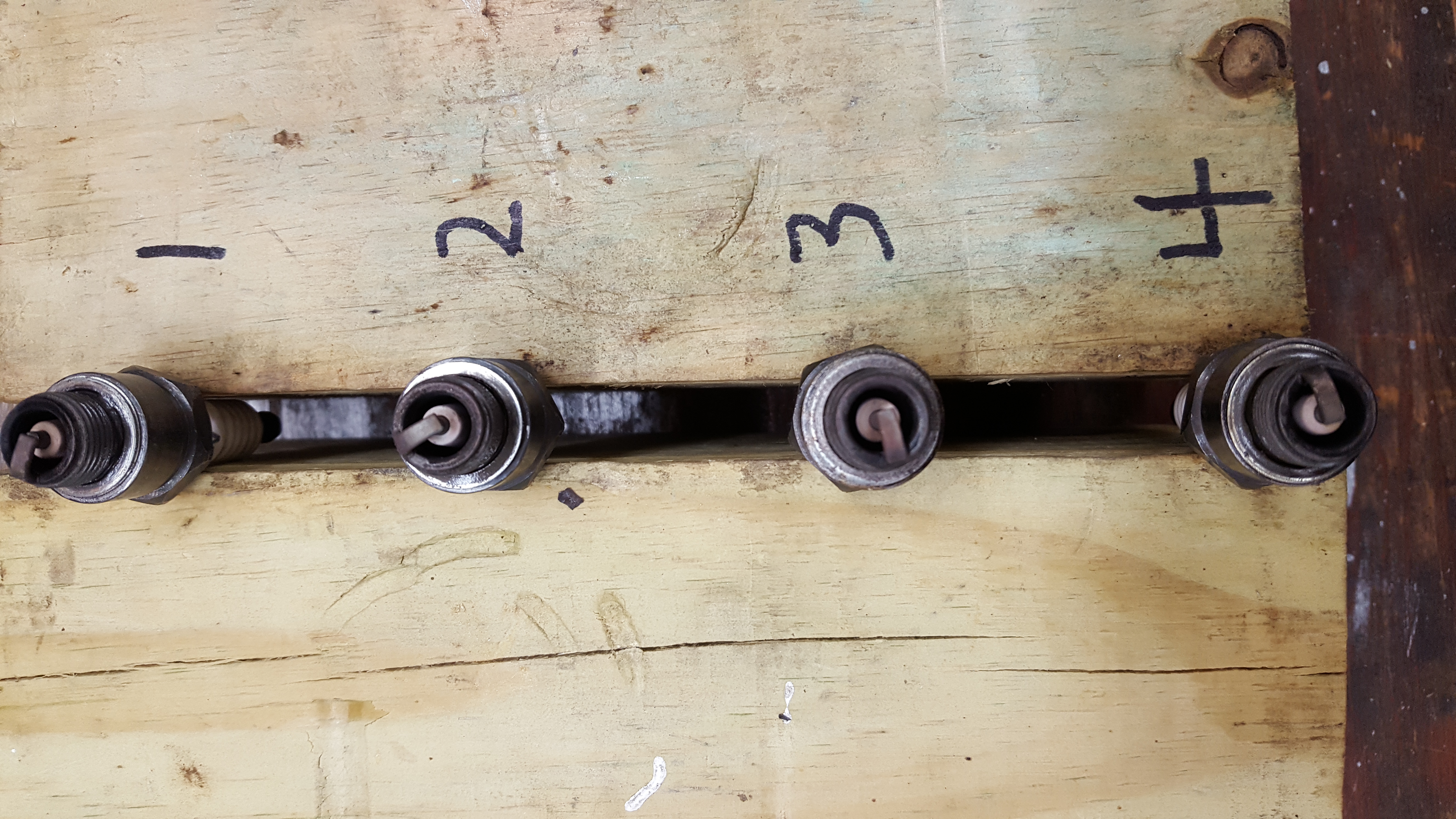

Hello All, My car is a stock 1939 Deluxe Tudor. I am looking for some help in interpreting recent compression test results. I did two tests back-to-back with the same results for both. The car was thoroughly warmed up after a 25 mile drive. Throttle was wide open. Cylinder Pressure 1 145 2 125 3 95 4 95 5 120 6 115 7 120 8 120 I am concerned about cylinders 1, 3, and 4. The car runs well. It starts readily and idles smoothly. However, I will get an occasional backfire out the tail pipe. I also did a vacuum test. It was steady at 22 inHg. Attached is a photo of spark plugs 1 – 4. Thanks for your insight. Larry

If the engine starts, runs and idles, I would not worry about an occasional pop in the exhaust. It could be caused by a slightly rich mixture or moisture in the gas. Moisture in the gas can be cleared up by using Heet or Seafoam. Here is a link to a site that shows what your plugs should look like. https://www.ngksparkplugs.com/about-ngk/faqs/spark-plug-faqs/how-do-i-read-a-spark-plug Your plugs all look normal to me. Tom

#1 cylinder with higher compression could be carbon build up caused by rich mixture or a weak spark plug. what do the plugs "read" color, deposits, etc
