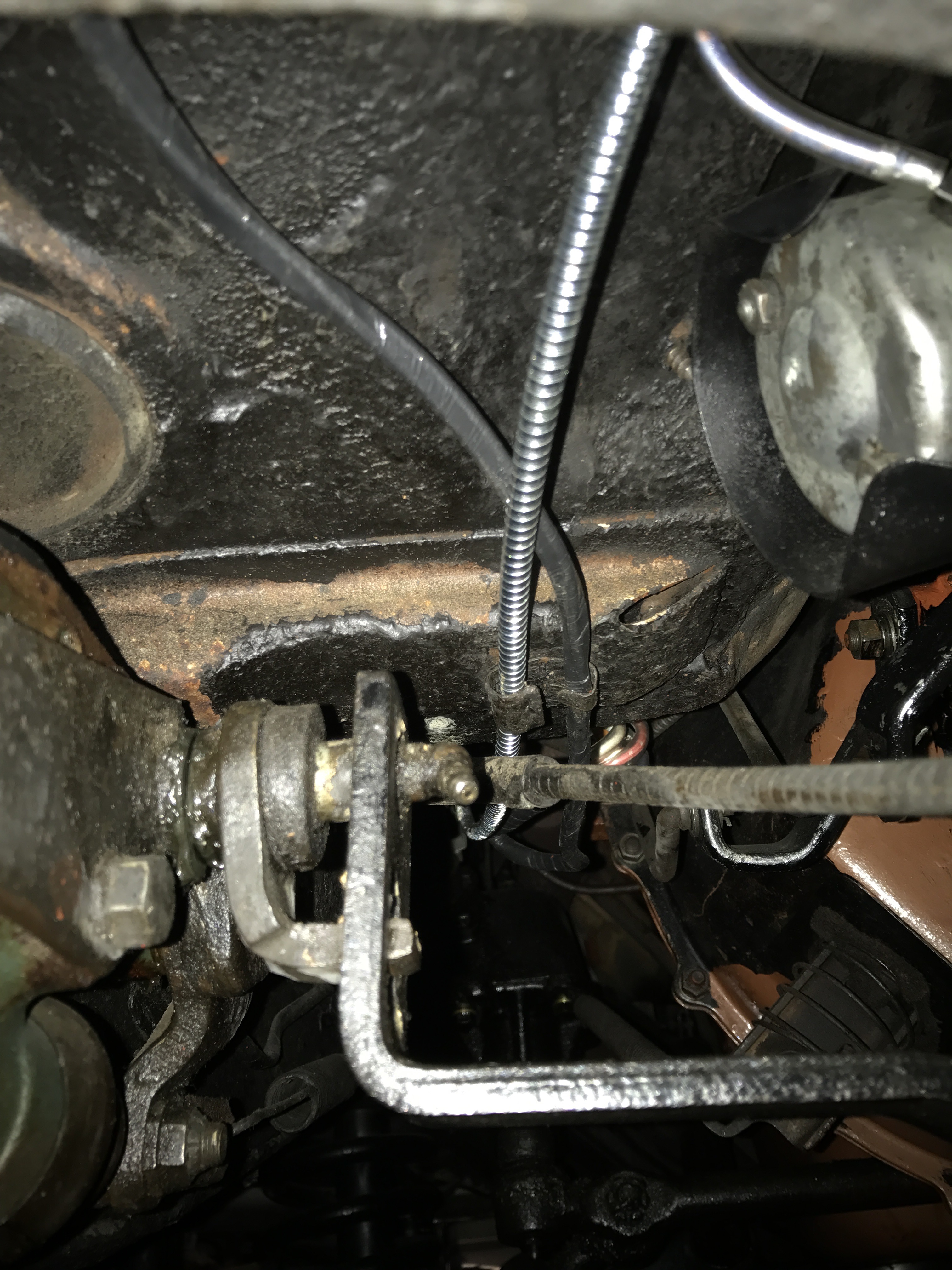

According to the '49-'53 Chassis Parts Catalog, the parking brake conduit and cable assembly for the '49-'50 (#8A-2853-C) for all except the convertible should be 75" long. I don't have a '50 handy, but I believe my '51 is similar. From the handle, the cable goes straight through the firewall, emerging in the top, inboard corner of the wheel well. It curves downward through a bracket that is held by a bolt in a hole about 1" forward of the bottom-forward bolt on the regulator. From there it goes under a raised channel in the bolt-in panel at the rear of the wheel well. Emerging under the car, it goes over the brake pedal and over the "U" shaped piece that connects the clutch pedal ending at a bracket on the cross member. Here are some pictures (see next two replies):

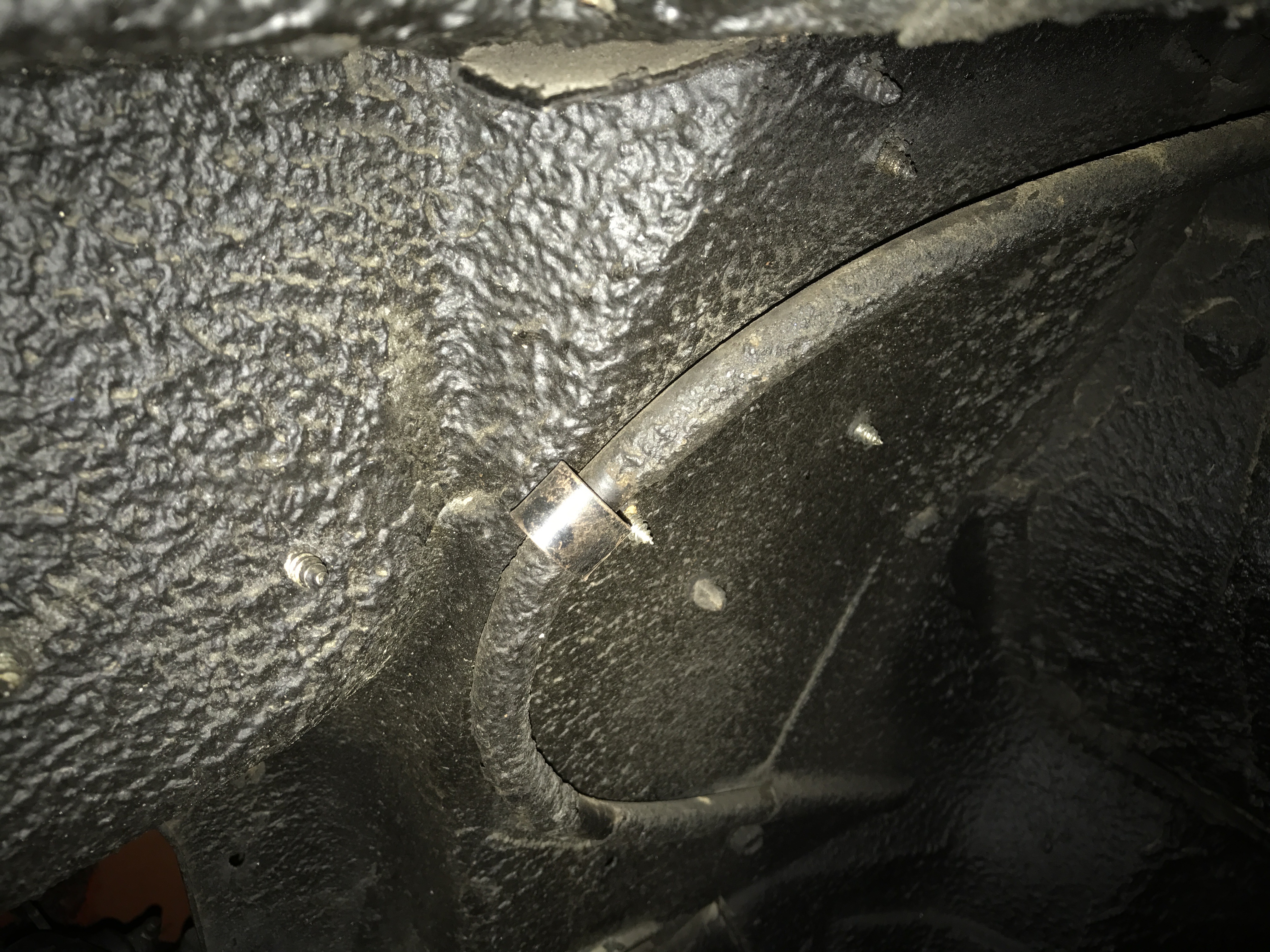

deluxe40 | -- 08-24-2017 @ 12:22 PM |
Picture 2: The brake cable is the darker cable running between the grease nipple and the speedometer cable.

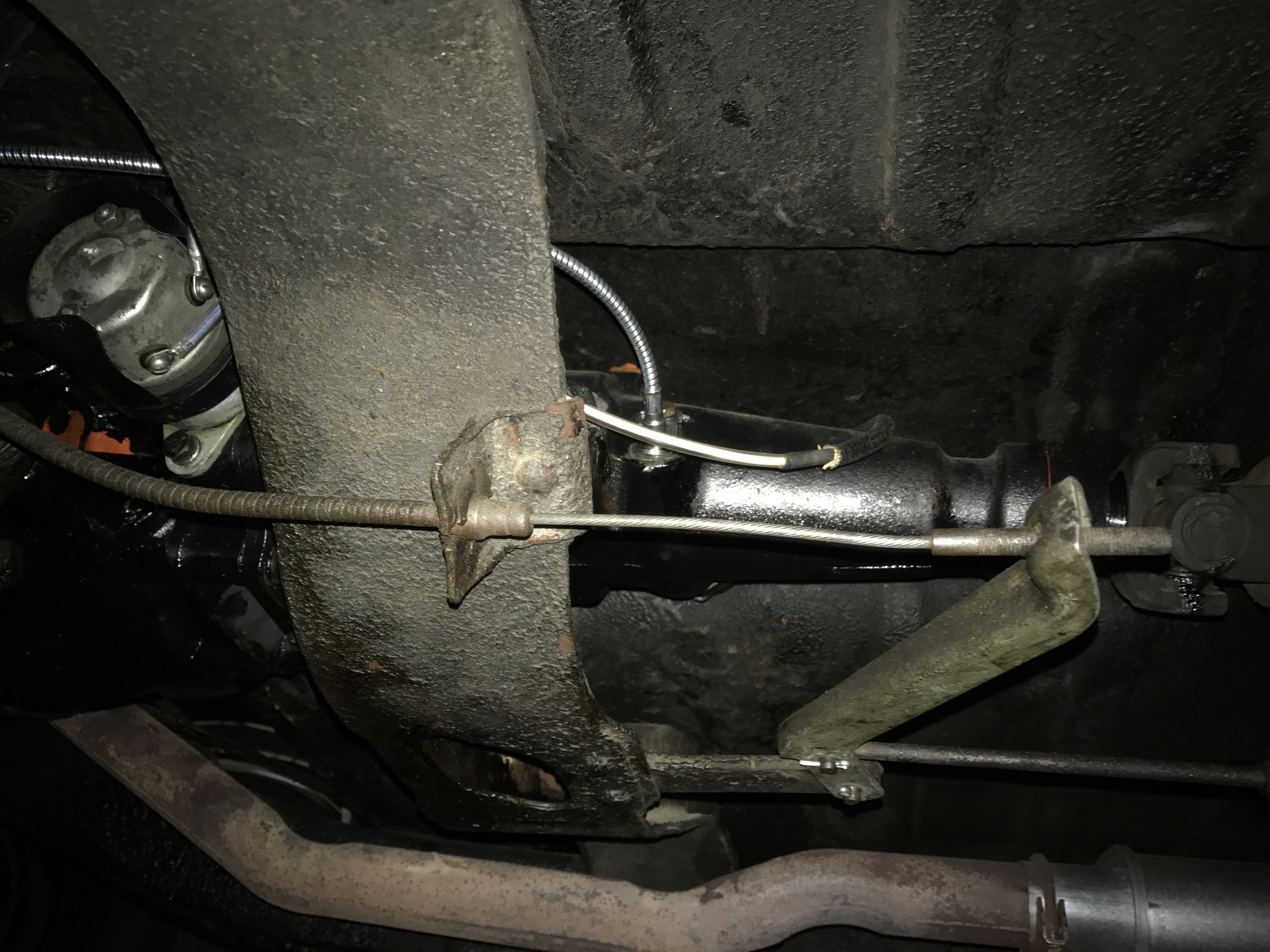

deluxe40 | -- 08-24-2017 @ 12:24 PM |
Picture 3 of 3: Brake cable attachment to frame bracket:
