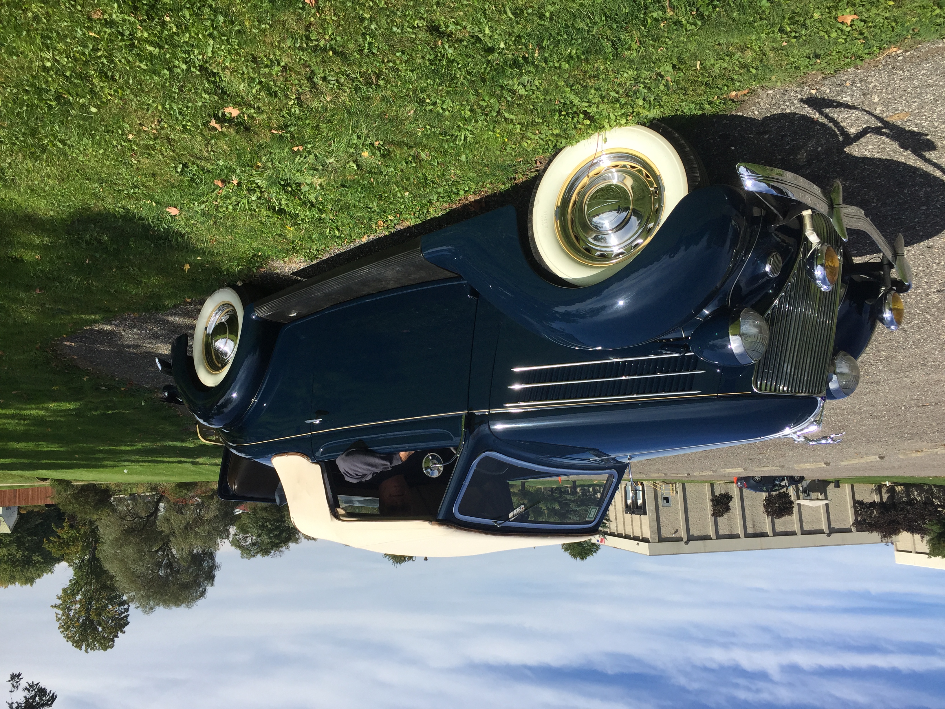

voced | -- 08-15-2017 @ 4:18 AM |
Thanks guy's, I will give your idea's a try. It is embarrassing to be at a car show with this beautiful Cabriolet and it sometimes acts like it won't start. Otherwise it runs like a new one. Jerry
len47merc | -- 08-15-2017 @ 4:23 AM |
Beautiful! Steve
TomO | -- 08-15-2017 @ 6:16 AM |
Jerry, your 36 Cabriolet looks great. When the cables or switch are corroded they can fail intermittently, but will always have a higher resistance than good ones. To check out the cables and the switch, do a voltage drop test. To get a good connection in the following tests, clean the battery posts and cable openings before the tests. Connect a voltmeter black or COM lead to the battery post and the red or + lead to the terminal on the starter. Crank the engine with the ignition off and check the voltage reading. It should be 0.3 Volts or less. If it is 0.3 V or less, your problem is not in the cables or switch. If it is higher, move the red lead to the next connection toward the battery, which should be the output of the starter switch. The reading should now be 0.2 V or less, if it is, replace the cable, if it is higher, go to the other side of the starter switch and repeat the test. The reading should now be 0.1 v or less. If it is the starter switch is the failing component. If it is higher, the battery cable is the culprit. To check the grounding of the starter, connect the red lead to the + terminal of the battery and the black lead to the case of the starter. Crank the engine with the ignition off and read the meter. The reading should be 0.1V or lower. Other things that can cause this problem are bad battery disconnect switch, weak brush springs, worn rear bushing in the starter motor and worn ignition rotor. Tom
