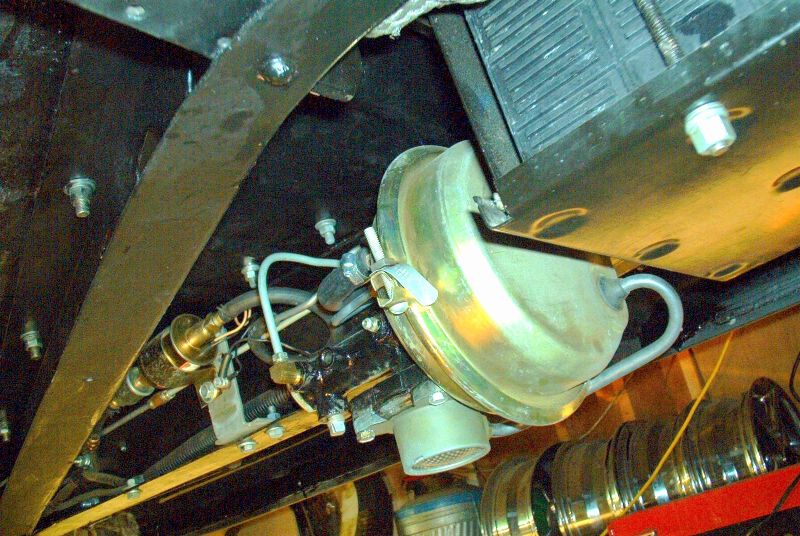

I guess I am going to disagree with some about mechanical brakes. To have effective mechanical brakes everything must be in near perfect condition. This means rods, bushings, wedges, springs, woven shoes, floaters and clevises. Some of these things are impossible to find in perfect condition and when found can be pricey. I have Ford hydraulics on my '35 and '36 using standard '46-'48 brakes, and a V8 Shop master cylinder fixture. This is coupled to a '57 T-Bird vacuum booster . The entire system is trouble free requiring minimal maintenance and literally rivals a new car in application. Tom
