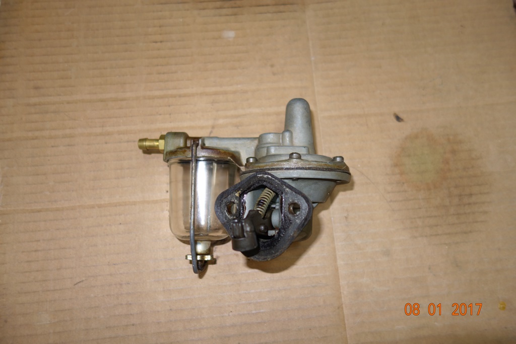

I haven't touched the rod. attached is a picture of the old pump This message was edited by Bob56 on 8-1-17 @ 1:26 PM

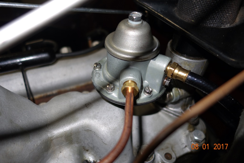

the new one. Somebody on another forum suggested the rod might have to be changed. since I have no clue looking for some guidance

Sorry to inform you but that is NOT a correct pump for 36. Other poster showed a correct early 36 pump. Later 36 pumps are slightly bigger but not glass bowl ones. I have 1 rebuilt 36 pump like in the other pic. ken ct. 1-203-260-9780

The fuel pump you have was used until approximately July of 36. So most of the 36 production used the style you have. I notice an unusual top bolt and gasket under it. To make sure the pump is developing proper vacuum to draw fuel in consider wrapping the upper cap to the die cast body with some electrical tape and if it then pumps fuel remove the tape. Sometimes if the top to body gasket is cork it can shrink and cause air to leak in preventing the pump from developing vacuum. Usually the cork gasket will swell up after fuel is in the pump and it will work well. Make sure the upper bolt is tight but do not over-tighten.

The correct early 36 pump is in pic posted at 1:25 pm. I have 1 left. ken ct.
