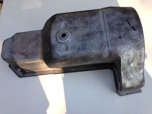

AND Ford even employs a device that's on the bottom of most oil pan clutch covers that appears to be simply a cotter pin inserted in a hole. It's FAR MORE than that. This device actually allows the oil leaking from the rear main seal to be "wicked"-out of, and thence blown-away by the air-stream under the car whilst driving. Attached is a photo of a V8-60 pan with the cotter-pin properly installed. This message was edited by Stroker on 7-31-17 @ 2:32 PM
Stroker | -- 07-31-2017 @ 2:33 PM |
OOPS, forgot the photo.
