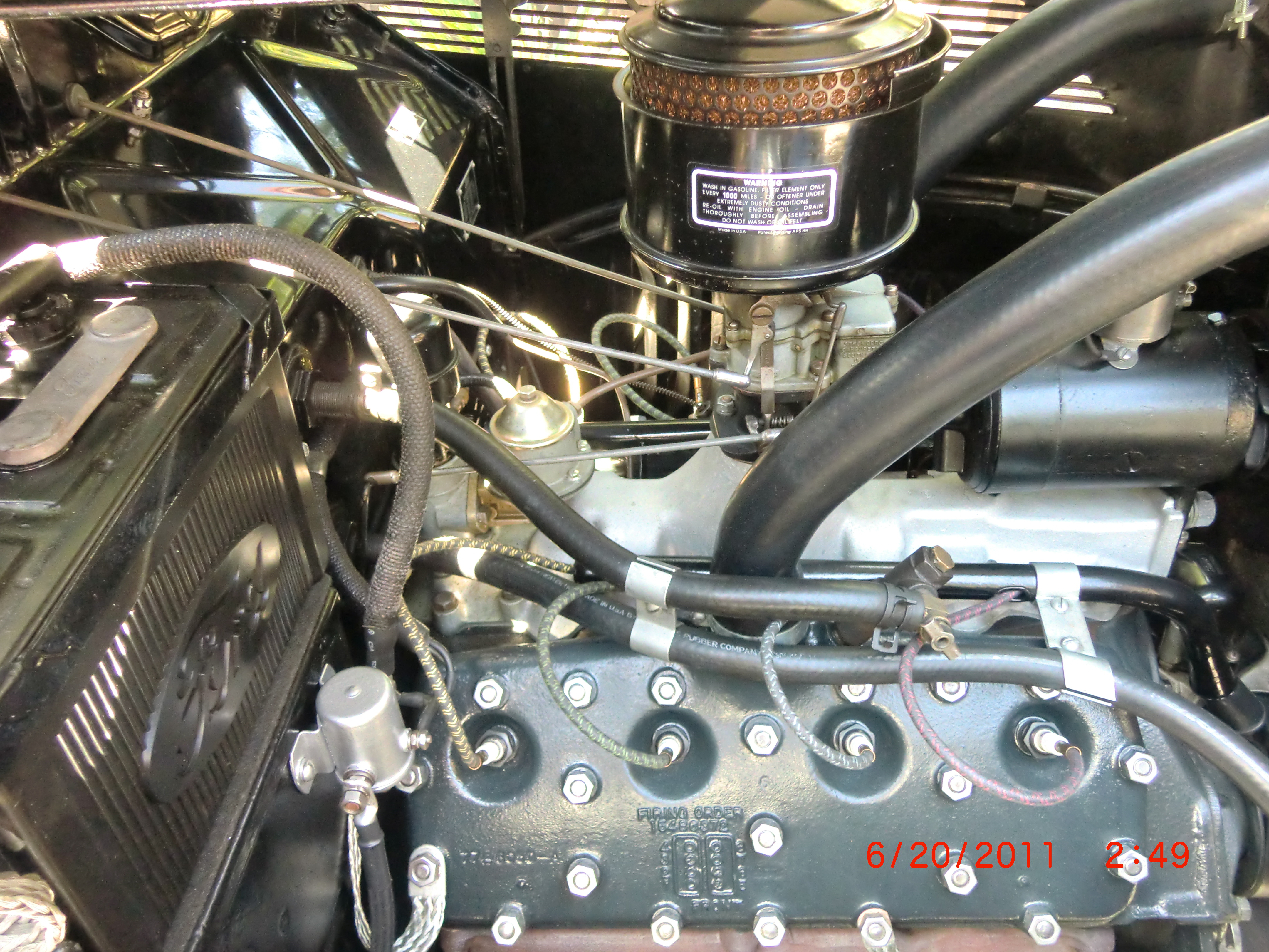

Attached below is a picture of the flathead engine in my '37 Ford. It is original to the car. Now, if you can post a picture of the engine in your '35 which should have its water pumps in the front of each cylinder head....

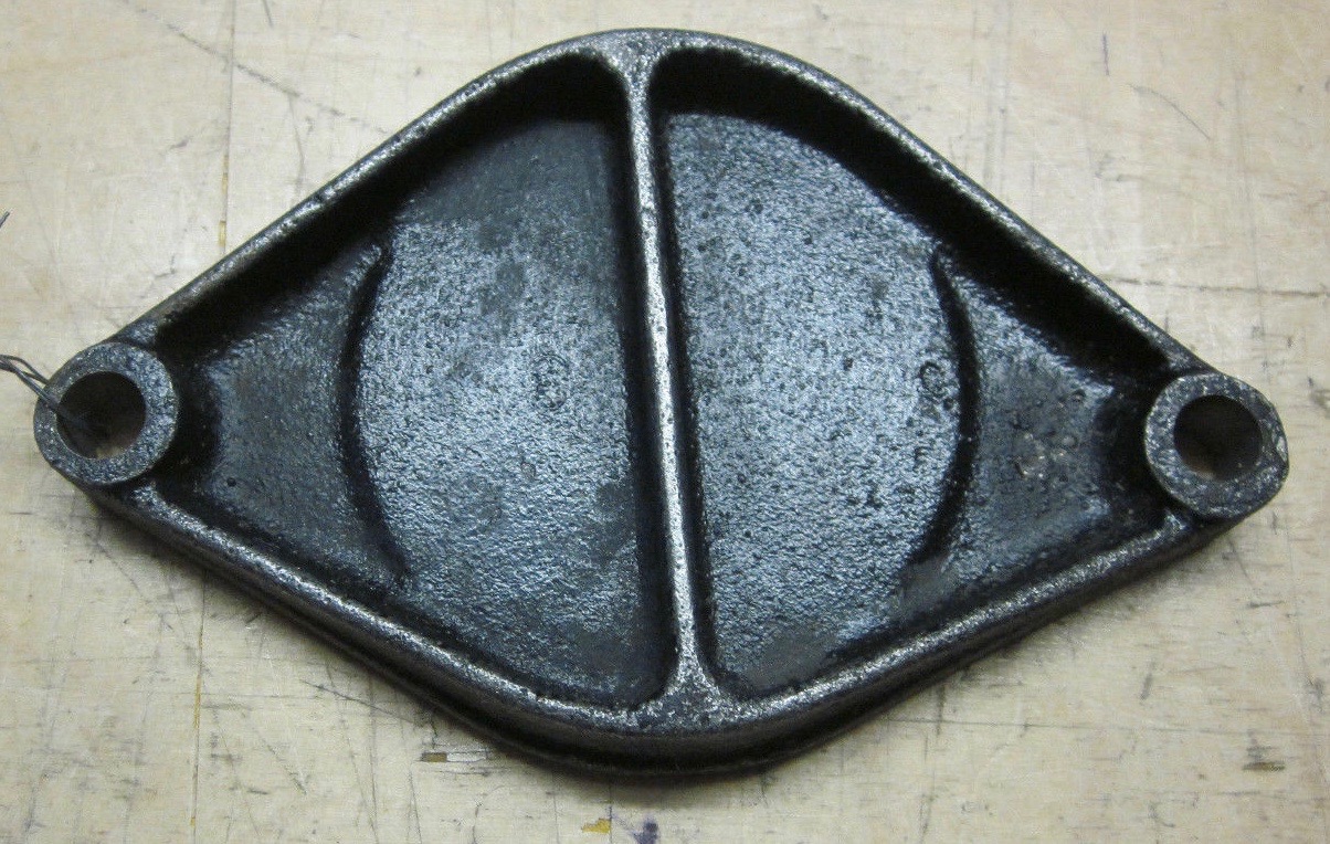

It is also possible that you have a '37 engine that someone has installed '35 heads on. The the pumps are in the front of the head and there is a provision for water pumps in the front of the block that has been covered with block off plates that is what you have. I have attached a photograph of the block off plate Ford made to enable dealers to install the '37 engine in the earlier cars. Charlie Stephens

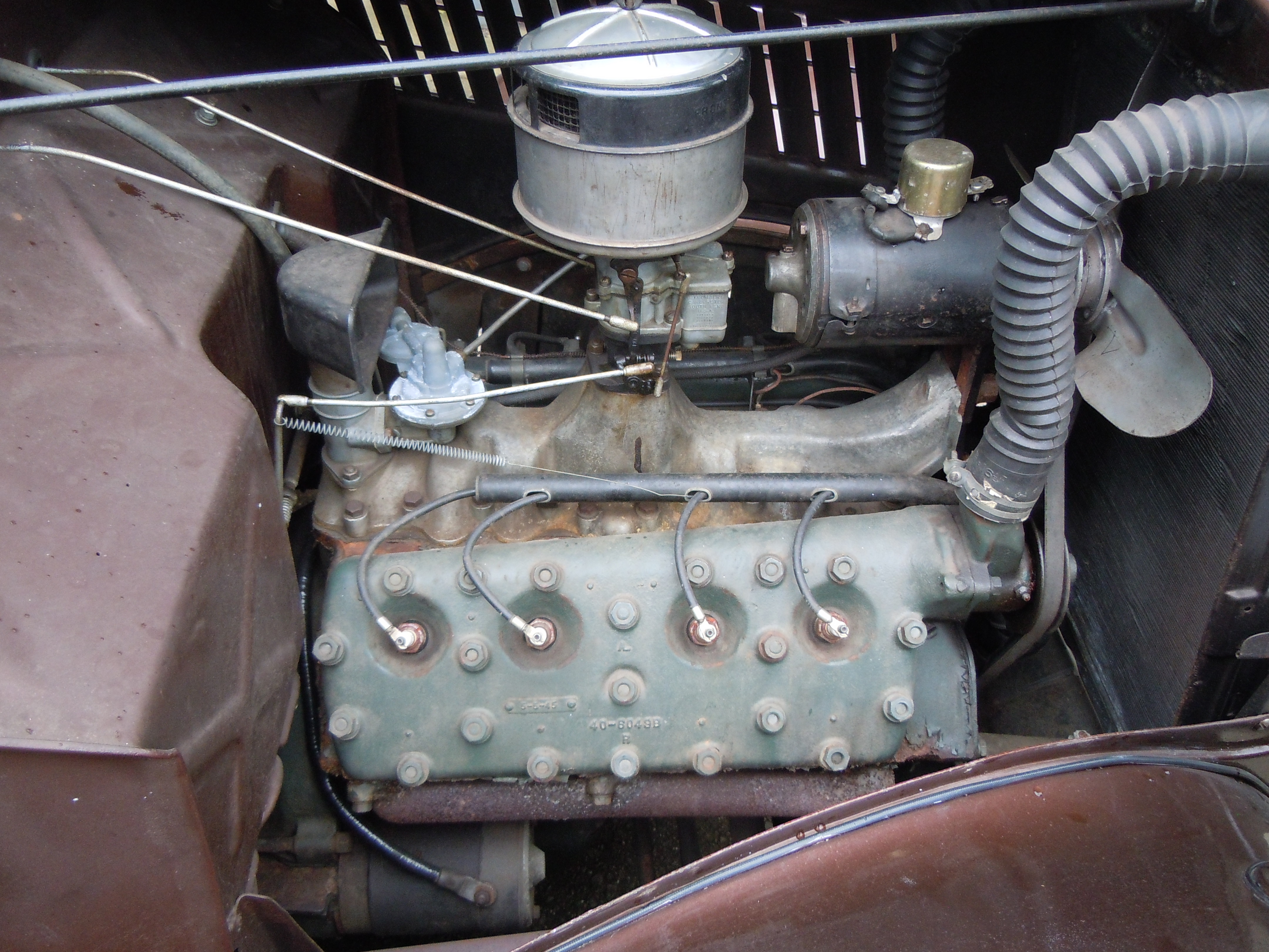

Hopefully this works. I have tried to attach a picture of the motor in my car. The water pumps are located in front of the motor at the end of the heads. I never understood when the change was made between dumping the radiator hoses into the top of the head as opposed to placing the water pumps at the end of the head. I need educated.
MG | -- 07-27-2017 @ 7:16 PM |
Yup, looks like you have the "block off plate" Charlie described above....

doghair3, In answer to your question. When the V8 came out in 1932 the pumps were at the front of the head. Beginning in 1937 the pumps were relocated to the front of the engine block and would remain there for the rest of flathead production (1953). This new location has two advantages. First with this design the water is under a slight pressure which raises the boiling point. The design with the pumps in the head sucked water out of the engine slightly reducing the pressure and the boiling point. The second advantage is that the water pumps are now pumping the cooler water from the bottom of the radiator when compared to the hotter water exiting the engine. The cooler water is a better environment for the water pumps. Charlie Stephens This message was edited by CharlieStephens on 7-27-17 @ 11:10 PM

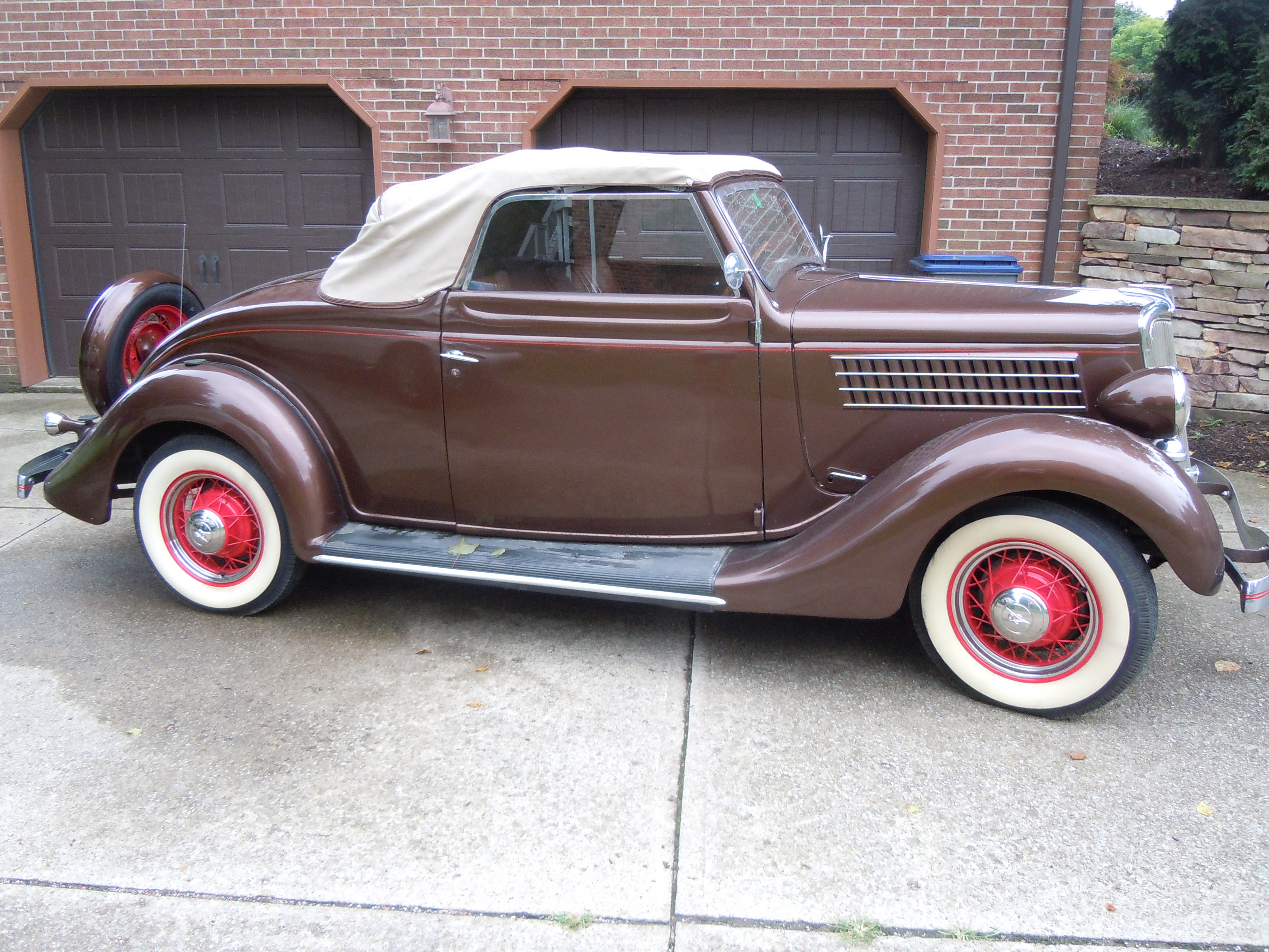

Thanks to all of you who tried to answer my question. But I admit I'm a little thick up top. Based an what MG and Charlie said (if I understand them correctly) I can assume My motor is original to a 35 model. Right? I guess I need to get a good book (with pictures haha) My best to all. Tom H.
MG | -- 07-28-2017 @ 8:21 PM |
It looks to me as though your car has a '37 engine with '35 cylinder heads.... It's a very nice car by the way....
CharlieStephens | -- 07-28-2017 @ 10:41 PM |
MG has it right. Your block is a '37 (or maybe '38). Charlie Stephens This message was edited by CharlieStephens on 7-28-17 @ 10:42 PM

Doghair3, Don't dispair, your 35 car with a 37 engine could last a lifetime with that later model engine with insert bearings. A real Early Ford guy might never notice the blockoff plates on the block, once they see the water pumps on the heads. It has been a common repair fix for 80 years now and you'll find lots of other early Ford V8's with the same fix if you look. If this engine performs well, forget it an enjoy the car as is. It's still a 35 Ford to me. 1934 Ford's since 1972
